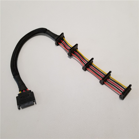

  11. Its been a while, so just a quick update. I was going to buy some new 1x4 cables as per the suggestion then I remembered I had some older 1x4 cables I could try, and it turned out I had three of the Silverstone SST-CP06 power cables, these have two high quality 2200µF capacitors included on the cable to provide stable voltage to all connected devices, so I removed the two 1x5 sata power cables and fitted these, and for now all drives started first time.
  12. Thanks I knew about the dodgy connectors, I will have a look at getting new cables to see if this solves my issue and get back to you.
  13. So if I get a molex to 4 sata cable "beefy" as you say, and I would need three, would I connect all three to the same rail? also, any recommendations of a "beefy" cable.

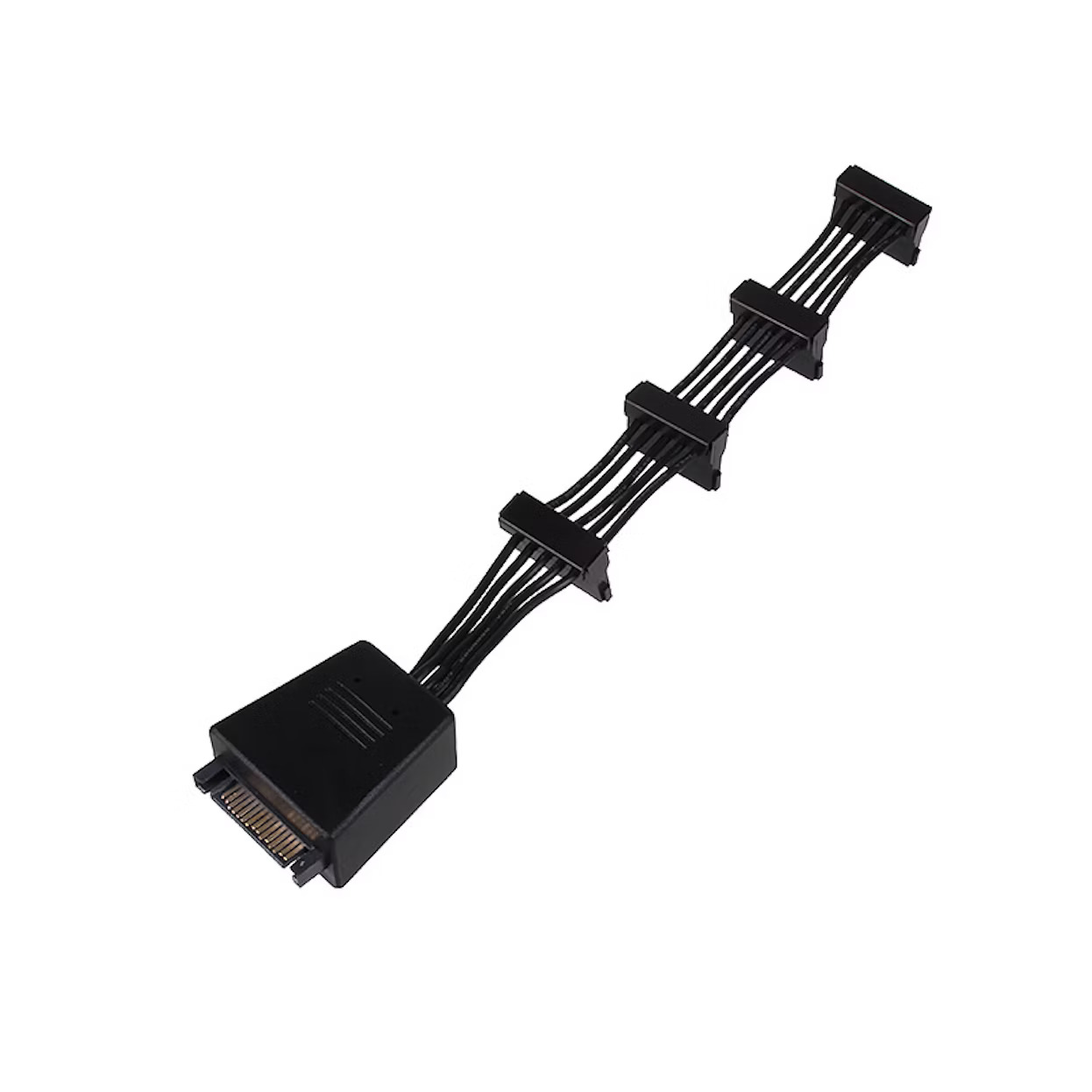

  14. Sata to Sata like this
  15. PSU is Corsair CX500M 500W, splitters yes x2 1 to 5 SATA
