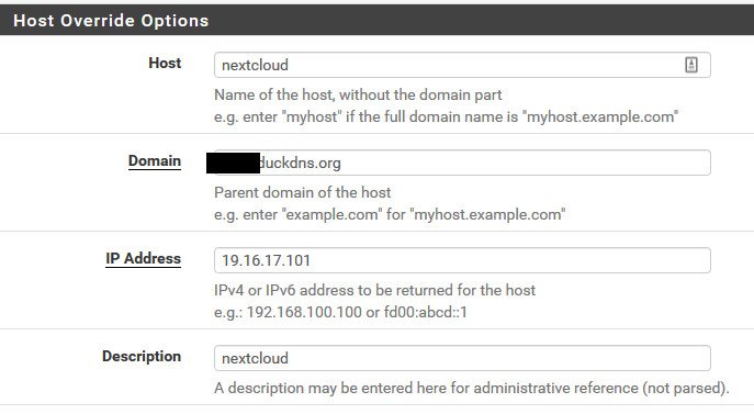

Thanks for your answers and sorry for my late response. Yes. Could this be causing the issue? I have to keep my ISP router on as it provides the TV connection. My pfsense box is in the DMZ of the ISP router. With this setting, I don't need to forward the ports from the ISP to the pfsense box. Yes Thanks for the tip. I tried it. Still no luck getting local access... My Custom options in the DNS Resolver (which is enabled) now look like this: server: private-domain: "unraid.net" local-zone: "nextcloud.XXX.duckdns.org" redirect local-data: "nextcloud.XXX.duckdns.org 3600 IN A 19.16.17.101" Are there any other troubleshooting steps I could take? Or steps to provide you guys with more accurate information regarding my issue ? oh. I guess I'll have to change that :(. Thanks for the heads up.

I already posted a few days ago regarding setting up letsencrypt for nextcloud and got from no access at all to remote access only, which i am very happy about. Remote access works perfectly with duckdns but i still can't get local access and that is what i am trying to fix. I will try to summarize the relevant information here. I run a pfsense router which is in the DMZ behind my ISP router. Both have NAT enabled. I have port forwarding rules setup and as remote access works, i tend to think that they are not the problem. I have a host override setup in pfsense: Here are the results of nslookup and tracert from a computer within the same network (behind pfsense) as the unraid server on which letsencrypt and nextcloud are running: My interpretation is that the dns override works as it is correctly resolved with the external (internet) ip. Is that correct? Or should a local dns lookup response be the local ip adress? The fact that the dns seems to work leads me to believe that the problem lies with my configuration of letsencrypt (possibly nextcloud?). Here is the result of a tracert showing the connection timing out: My current configuration of LE and nextcloud: appdata/letsencrypt/nginx/site-confs/nextcloud server { listen 443 ssl; listen [::]:443 ssl; server_name nextcloud.*; include /config/nginx/ssl.conf; client_max_body_size 0; location / { include /config/nginx/proxy.conf; resolver 127.0.0.11 valid=30s; set $upstream_nextcloud nextcloud; proxy_max_temp_file_size 2048m; proxy_pass https://$upstream_nextcloud:443; } } appdata/nextcloud/www/nextcloud/config/config.php <?php $CONFIG = array ( 'memcache.local' => '\\OC\\Memcache\\APCu', 'datadirectory' => '/data', 'instanceid' => 'XXX', 'passwordsalt' => 'XXX', 'secret' => 'XXX', 'trusted_domains' => array ( 0 => '19.16.17.101:444', 1 => 'nextcloud.XXX.duckdns.org', ), 'dbtype' => 'mysql', 'version' => '16.0.1.1', 'overwrite.cli.url' => 'https://nextcloud.XXX.duckdns.org', 'overwritehost' => 'nextcloud.XXX.duckdns.org', 'overwriteprotocol' => 'https', 'dbname' => 'nextcloud', 'dbhost' => '19.16.17.101:3306', 'dbport' => '', 'dbtableprefix' => 'oc_', 'mysql.utf8mb4' => true, 'dbuser' => 'XXX', 'dbpassword' => 'XXX', 'installed' => true, ); I am quite a networking newbie. I have tried to read and inform myself as much as i could, but i can't seem to figure this out. Any help would be greatly appreciated.

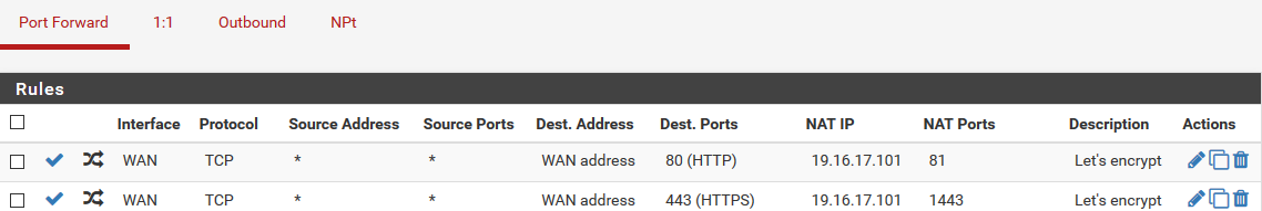

Thanks for the tip @blaine07. I have no problems reaching nextcloud externally, which leads to me to think that my port forwarding rules are okay. It's only internally that the connection times out. Heres a screen of my rules:

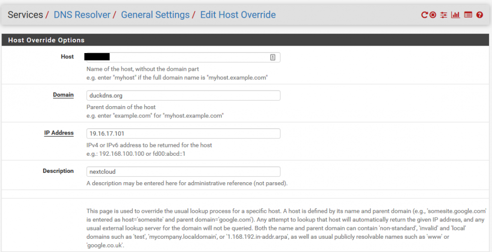

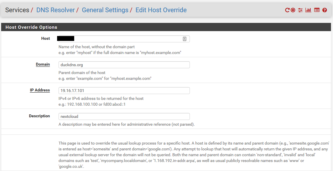

Thanks for your correction. I previously used mydomain.duckdns.org to reach nextcloud directly. I now made the change in the nextcloud and letsencrypt config to have nextcloud at nextcloud.mydomain.duckdns.org. I can reach nextcloud remotely, but still not locally (timeout) :(. Here is my Host override in the DNS resolver:

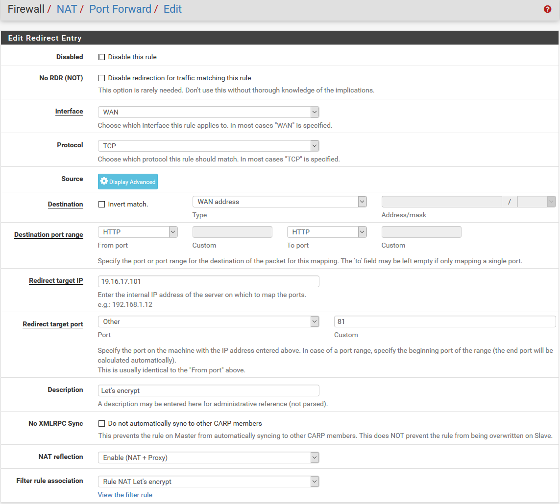

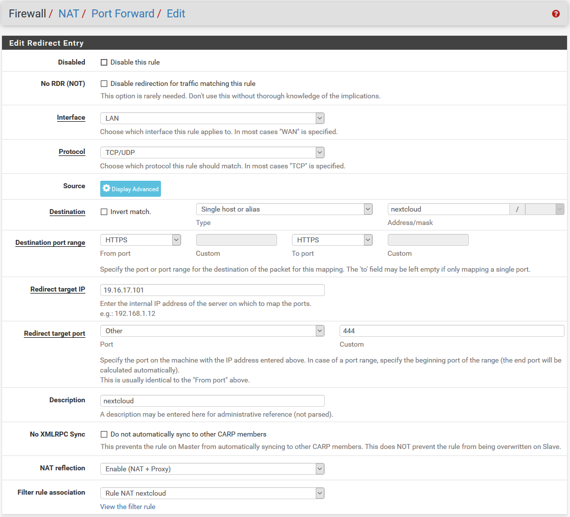

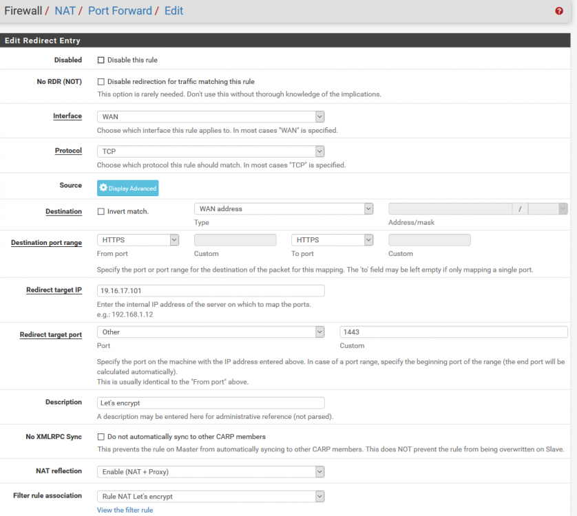

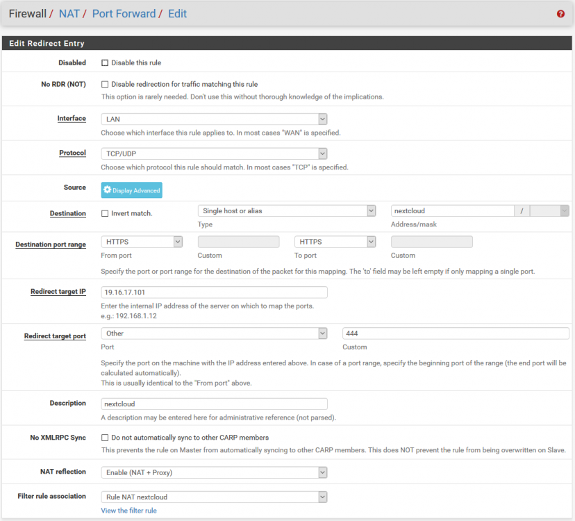

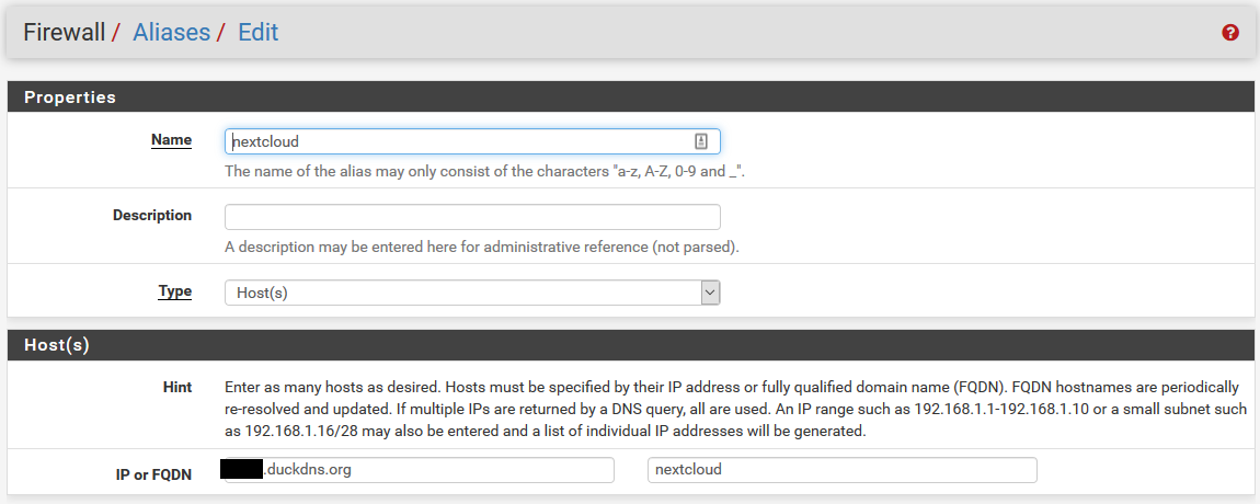

Thanks! I got remote access! However, still no access from the local network. I only setup my pfsense router after moving (with my new ISP router that doesnt support NAT loopback). I never got local access working with this ISP router. I tried unchecking "block private networks and loopback addresses" (both on WAN and LAN) but no change. canyouseeme.org reports that port 443 is open, 80 is not. I tried setting up a NAT forward rule to be able to gain local access, but no succes: Any suggestion?
[Support] Linuxserver.io - SWAG - Secure Web Application Gateway (Nginx/PHP/Certbot/Fail2ban)

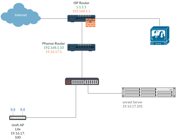

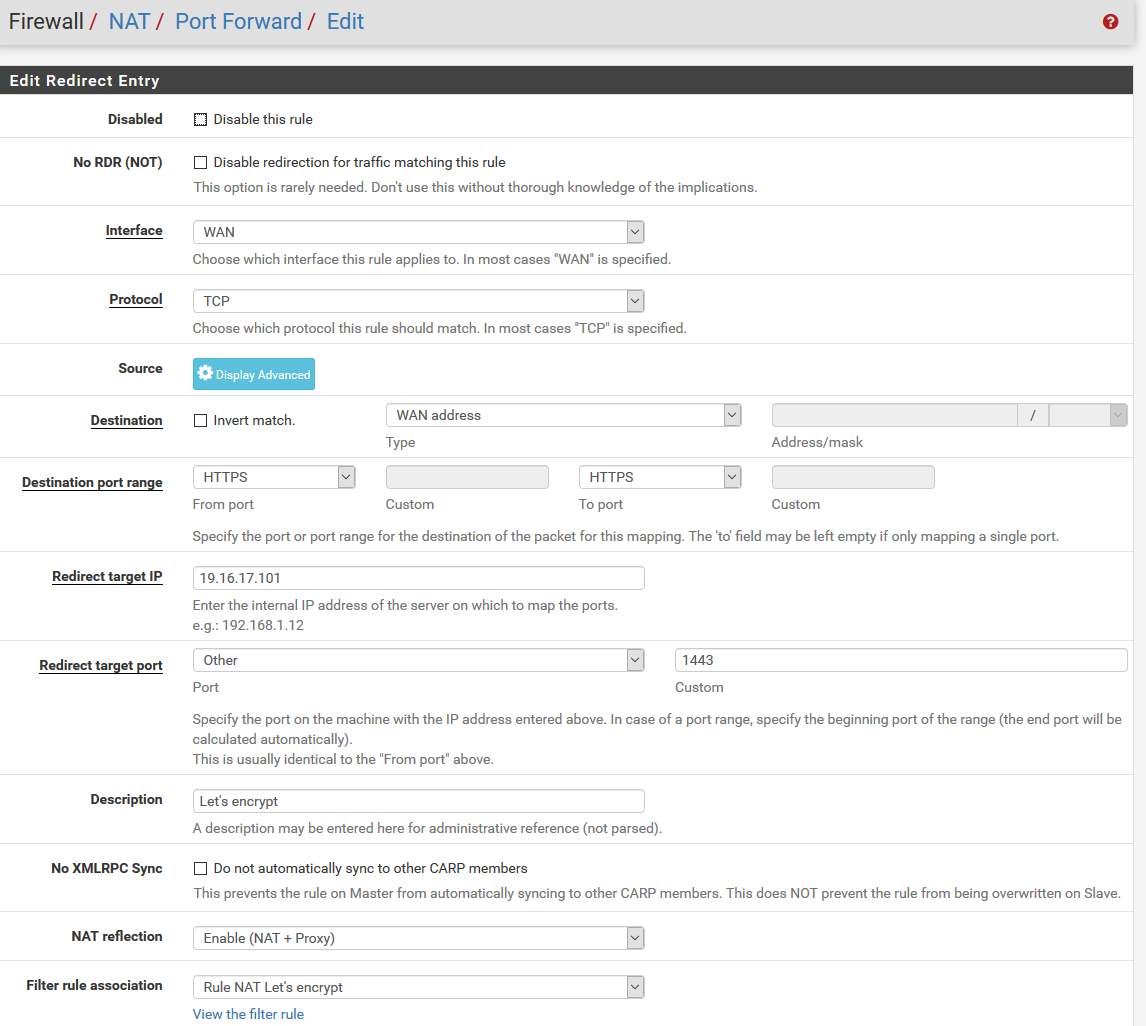

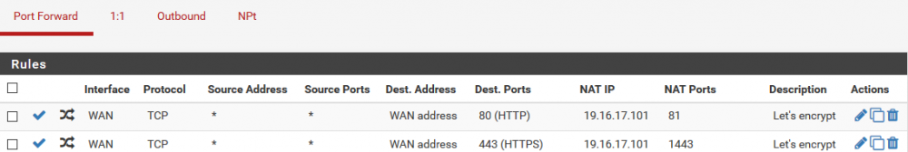

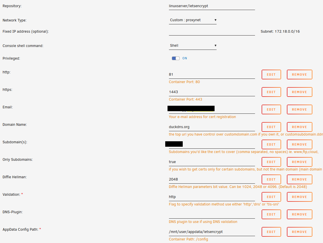

Hi I previously had a working nextcloud instance with reverse proxy, but i kept having problems after i moved and got a new ISP router. I have made several unsuccesful attempts in the past months to get it working so tonight i'm finally posting here and hope someone can help. Nextcloud is setup and works just fine on the local network. Let's encrypt is able to get new certs and to renew old ones. My issues lies with setting up the reverse proxy to access nextcloud with my duckdns URL. It times out whenever i try to reach the site from behind the pfsense router, the internet or behind the isp router. I would very much appreciate any help or suggestion. Below i posted my config. My network: The Pfsense Router is in the DMZ of the ISP router Here are my port forwards in both routers (first ISP router then pfsense) NAT loopback is enabled in the pfsense port forwards. Here is my letsencrypt template: appdata/letsencrypt/nginx/site-confs/nextcloud server { listen 443 ssl; server_name XXX.duckdns.org; root /config/www; index index.html index.htm index.php; ###SSL Certificates ssl_certificate /config/keys/letsencrypt/fullchain.pem; ssl_certificate_key /config/keys/letsencrypt/privkey.pem; ###Diffie–Hellman key exchange ### ssl_dhparam /config/nginx/dhparams.pem; ###SSL Ciphers ssl_ciphers 'ECDHE-RSA-AES128-GCM-SHA256:ECDHE-ECDSA-AES128-GCM-SHA256:ECDHE-RSA-AES256-GCM-SHA384:ECDHE-ECDSA-AES256-GCM-SHA384:DHE-RSA-AES128-GCM-SHA256:DHE-DSS-AES128-GCM-SHA256:kEDH+AESGCM:ECDHE-RSA-AES128-SHA256:ECDHE-ECDSA-AES128-SHA256:ECDHE-RSA-AES128-SHA:ECDHE-ECDSA-AES128-SHA:ECDHE-RSA-AES256-SHA384:ECDHE-ECDSA-AES256-SHA384:ECDHE-RSA-AES256-SHA:ECDHE-ECDSA-AES256-SHA:DHE-RSA-AES128-SHA256:DHE-RSA-AES128-SHA:DHE-DSS-AES128-SHA256:DHE-RSA-AES256-SHA256:DHE-DSS-AES256-SHA:DHE-RSA-AES256-SHA:AES128-GCM-SHA256:AES256-GCM-SHA384:AES128-SHA256:AES256-SHA256:AES128-SHA:AES256-SHA:AES:CAMELLIA:DES-CBC3-SHA:!aNULL:!eNULL:!EXPORT:!DES:!RC4:!MD5:!PSK:!aECDH:!EDH-DSS-DES-CBC3-SHA:!EDH-RSA-DES-CBC3-SHA:!KRB5-DES-CBC3-SHA'; ###Extra Settings### ssl_prefer_server_ciphers on; ###ssl_session_cache shared:SSL:10m; ### Add HTTP Strict Transport Security ### add_header Strict-Transport-Security "max-age=63072000; includeSubdomains"; add_header Front-End-Https on; client_max_body_size 0; location / { proxy_pass https://19.16.17.101:444/; proxy_max_temp_file_size 2048m; include /config/nginx/proxy.conf; } } appdata/nextcloud/www/nextcloud/config/config.php <?php $CONFIG = array ( 'memcache.local' => '\\OC\\Memcache\\APCu', 'datadirectory' => '/data', 'instanceid' => 'XXX', 'passwordsalt' => 'XXX', 'secret' => 'XXX', 'trusted_domains' => array ( 0 => '19.16.17.101:444', 1 => 'XXX.duckdns.org', ), 'dbtype' => 'mysql', 'version' => '16.0.1.1', 'overwrite.cli.url' => 'https://XXX.duckdns.org', 'overwritehost' => 'XXX.duckdns.org', 'overwriteprotocol' => 'https', 'dbname' => 'nextcloud', 'dbhost' => '19.16.17.101:3306', 'dbport' => '', 'dbtableprefix' => 'oc_', 'mysql.utf8mb4' => true, 'dbuser' => 'XXX', 'dbpassword' => 'XXX', 'installed' => true, );
