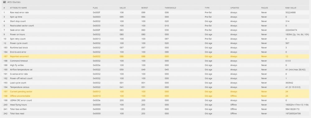

@johnnie.black @jonathanm @jbartlett ok guys finally finally extended smart test on my disk2 has completed could you guys take a look and let me know does this one needs to be replaced too ?.unraid-smart-20190729-1724.zip

wow that was actually my disk1 which up until yesterday was working just fine, it was my disk2 which was giving speedgap errors. in just 2 years both of my drives are dying or dead (disk1), never ever buying seagte drives again. Btw how long does an extended smart test take, my disk2 is still going.
DiskSpeed, hdd/ssd benchmarking (unRAID 6+), version 2.10.10

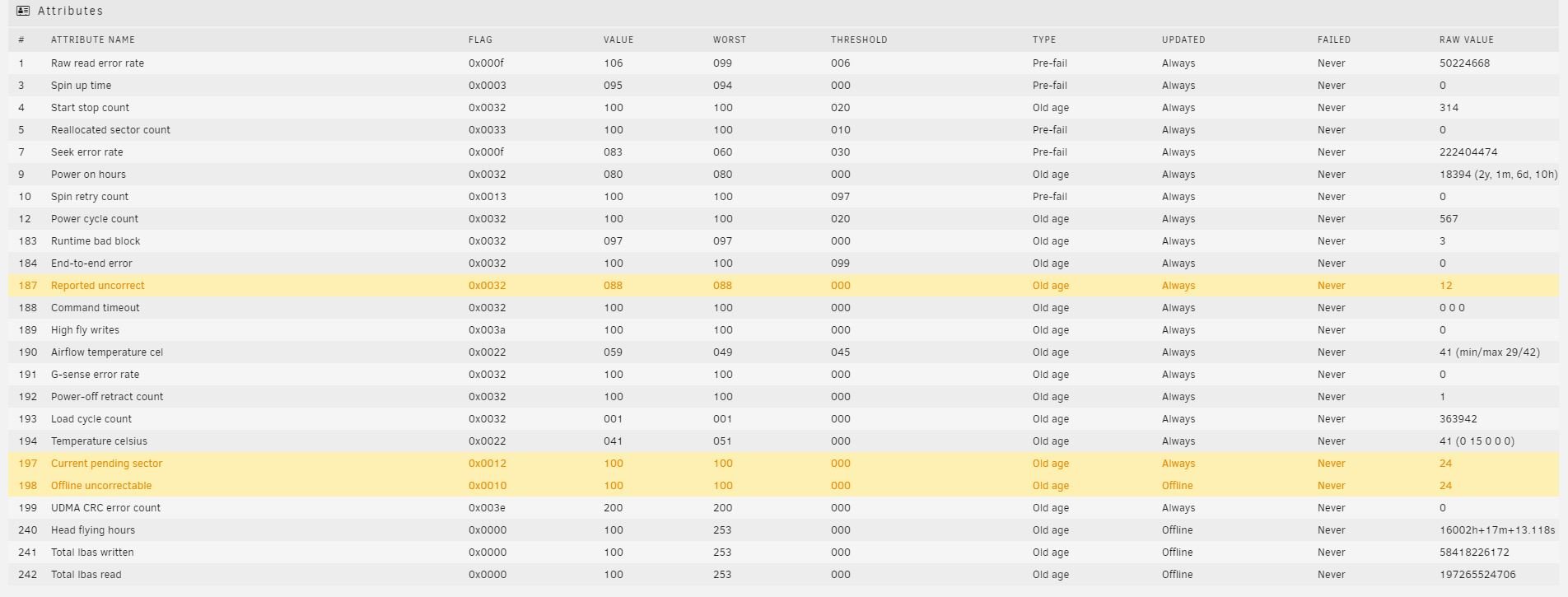

as you guys suggested i copied all of my important data first and tried running extended smart test on disk1 but it failed in just a matter of couple of seconds. it sis saying that some errors occurred check smart test report. could you take a look at my smart test report and help me figuring it out. unraid-smart-20190729-1717.zip
@jonathanm @jbartlett yesterday night my disk1 started to throw some error in smart test. looks like now i will have to change my disk2 as well. right?
@jbartlett @jonathanm thanks, i will copy my data to a new drive, then i will add that drive as disk2. i just can't believe they are already failing just two week ago their warranty has expired, guess im never buying seagate barracuda drive again.

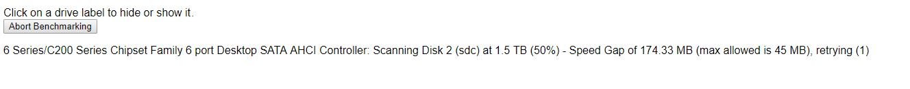

it was consistent on almost entire disk2, i think it was only once around 30-40% mark where speed gap didn't appear. so this mean i should add parity immediately and be prepared with another to replace it with ?

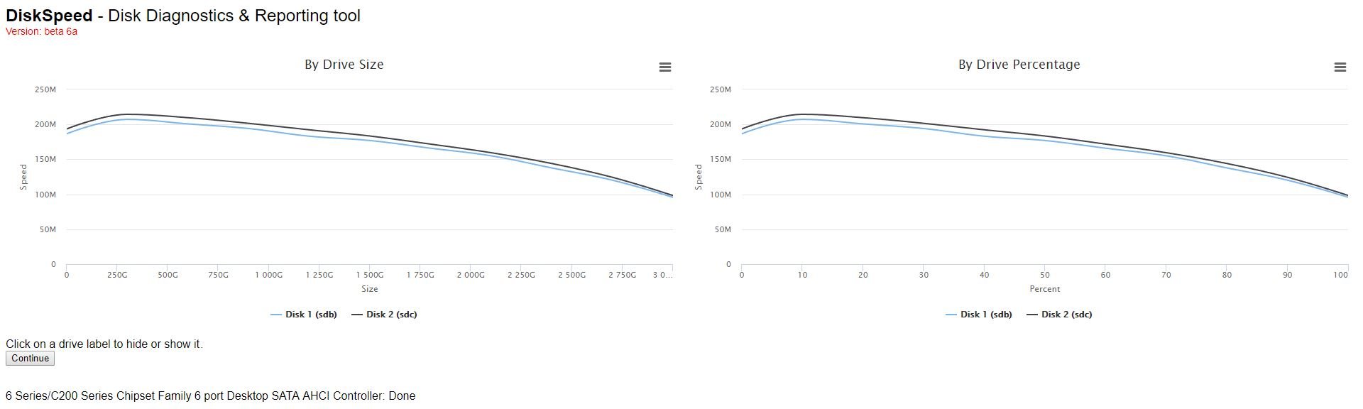

recently i was having some issues with read speed, which i fixed with the help of @johnnie.black . but then i noticed that somehow i wasn't getting good speeds from some of my files on disk2, for which @itimpi suggested me that sometimes hard drives may develop slow areas, so he suggested me to try this docker. So then i tried ran bechmark in safe mode (no gui no plugin) and here are my results graph looks fine to me but while the test was running on disk2 is was getting some speedgap error which i didn't get while it was running on disk1. so could anyone help me figure out what was that about ? is their something wrong with my disk2.
