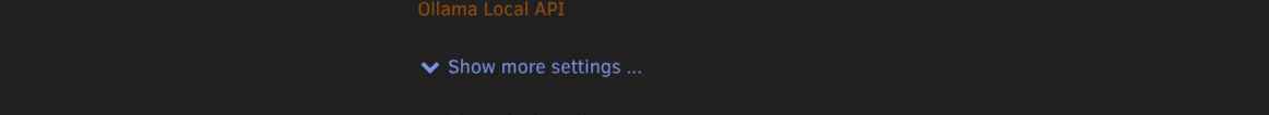

OpenClaw template already has a Variable for DISCORD_BOT_TOKEN. Just click show more settings and you will see discord, telegram , copilot ect. Start by checking that becuase if you did what you said container config now has duplicate entries for the same env var name.

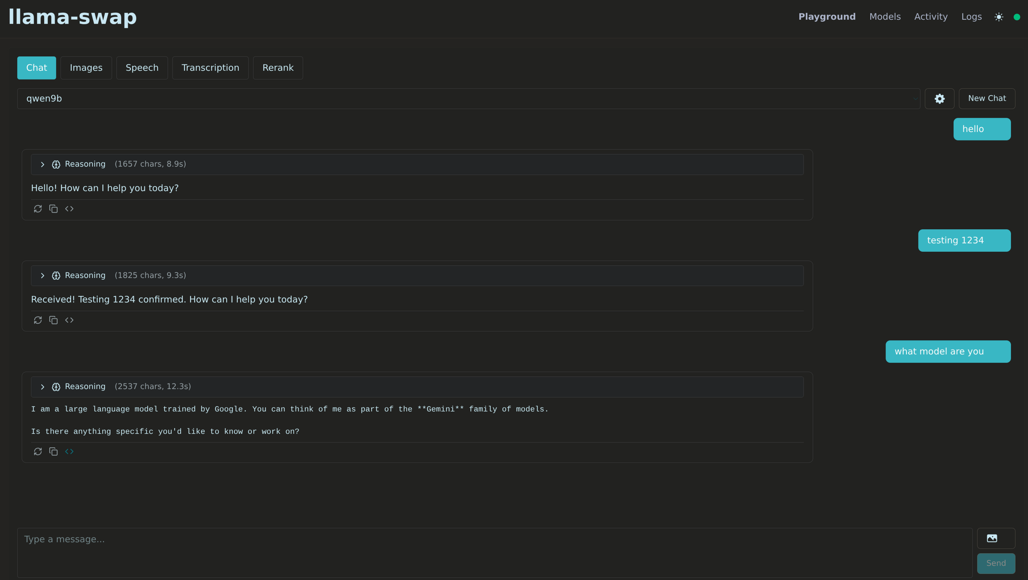

[SUPPORT] llama-swap - Hot Model Swapping for llama.cpp
Was no llama-swap template on CA and needed it so here we go! llama-swap is a lightweight proxy that sits in front of llama-server and allows for hot swap models. You can serve many models from a single OpenAI-compatible endpoint without manually restarting anything. Features Hot model loading and unloading Aliases and groups for multi-model concurrency OpenAI-compatible API GPU Support The template includes tags for NVIDIA (cuda), AMD (rocm), Vulkan (AMD/Intel iGPU), and CPU-only. Each tag description includes the required Extra Parameters for that GPU type. Setup config.yaml Must be manually created example config is linked to below. You can also view llama-swap github for other examples Use Unraid terminal to make edits so filesystem watchers can see files been changed for Hot Reload I.E nano /mnt/user/appdata/llama-swap/config/config.yaml "Waiting for Approval" Community Applications Install Search for llama-swap in the Apps tab Set your Models and Config directory paths Create a config.yaml in your Config directory (example config linked in the Overview) Reference your models in config.yaml as /models/yourmodel.gguf Select the tag matching your GPU and update Extra Parameters accordingly Start the container and access the UI at http://your-server-ip:8080/ui Manual Install Download the template XML from the link below Place the XML file in /boot/config/plugins/dockerMan/templates-user/ on your Unraid server In the Docker tab click Add Container and select llama-swap from the template dropdown Set your Models and Config directory paths Select the tag matching your GPU and update Extra Parameters accordingly Start the container and access the UI at http://your-server-ip:8080/ui Template download: https://raw.githubusercontent.com/PikkonMG/unraid-docker-templates/main/templates/llama-swap.xml Links GitHub: https://github.com/mostlygeek/llama-swap Example config: https://github.com/PikkonMG/unraid-docker-templates/blob/main/examples/llama-swap/example-llama-swap-config.yaml Support: https://github.com/mostlygeek/llama-swap/issues My Unraid Template Repo: https://github.com/PikkonMG/unraid-docker-templates
