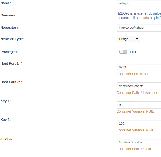

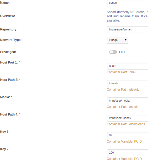

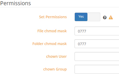

  7. I've been having the same kind of errors as Gog. The renaming issue also happens with Radarr although here, of course, we'll focus on Sonarr. I'll provide everything I can think of here. Please let me know what I might be overlooking.
