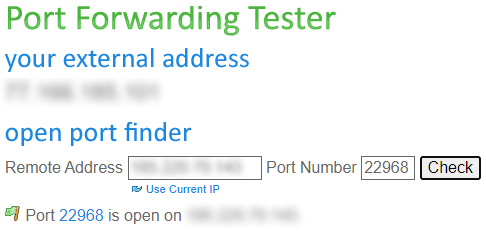

  6. I seem to have this problem where I cannot connect to peers. I made a video to easily show what happens: qBittorrent_peers_issue.mp4 I'm using PIA and here are the logs: https://pastebin.com/gTyE4AcZ. My machine is directly accessible through the internet so my LAN_NETWORK is set to 110.111.112.113/32, where this is of course an example IP. I checked the documentation and I think Q6 is about this. So I checked the whole answer, but only the first point is relevant: Incoming port not defined correctly. This seems the most likely cause, although the logs seem to say ports are open. If I check qBittorrent connection tab I see it's using port 22968. Docker tells me the following ports are opened: 0.0.0.0:6881->6881/tcp, 0.0.0.0:6881->6881/udp, 8080/tcp, 0.0.0.0:8118->8118/tcp. Port is open. See edit below. So I have no idea what's causing this. My docker-compose.yml looks like this: qbit: image: binhex/arch-qbittorrentvpn:latest container_name: qbit restart: always networks: - proxy cap_add: - NET_ADMIN ports: - 6881:6881 - 6881:6881/udp # - 8080:8080 - 8118:8118 volumes: - /etc/localtime:/etc/localtime:ro - ./qbittorrent:/config - /home/user/downloads/:/downloads environment: - VPN_ENABLED=yes - VPN_USER=$VPN_USERNAME - VPN_PASS=$VPN_PASSWORD - VPN_PROV=pia - STRICT_PORT_FORWARD=yes - ENABLE_PRIVOXY=no - LAN_NETWORK=110.111.112.113/32 - NAME_SERVERS=209.222.18.222,84.200.69.80,37.235.1.174,1.1.1.1,209.222.18.218,37.235.1.177,84.200.70.40,1.0.0.1 #- ADDITIONAL_PORTS=1234 - DEBUG=false - WEBUI_PORT=8080 - UMASK=000 - PUID=$PUID - PGID=$PGID labels: - "traefik.enable=true" # HTTP Routers - "traefik.http.routers.qbittorrent-rtr.entrypoints=https" - "traefik.http.routers.qbittorrent-rtr.rule=Host(`qbit.$DOMAINNAME`)" - "traefik.http.routers.qbittorrent-rtr.tls=true" # Middlewares - "traefik.http.routers.qbittorrent-rtr.middlewares=chain-authelia-auth@file" # HTTP Services - "traefik.http.routers.qbittorrent-rtr.service=qbittorrent-svc" - "traefik.http.services.qbittorrent-svc.loadbalancer.server.port=8080" I cannot download anything right now, so please help me out! Edit: The port is open apparently! So that cannot be the issue:
