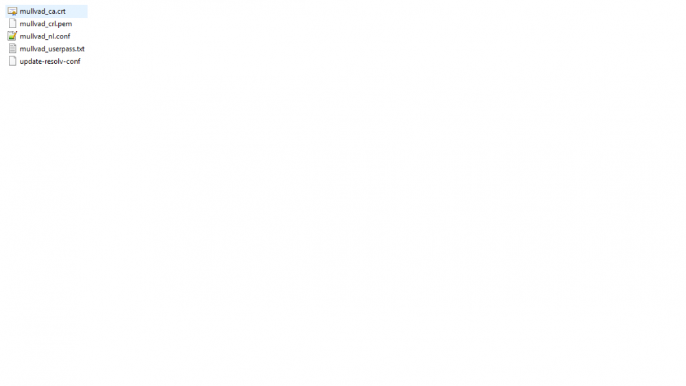

  17. i have attatched my supervisor log and a screenshot of what files i get from mullvad when i download the linux configuration. I should add that i changed it from mullvad_nl.conf to mullvad_nl.ovpn supervisord.log
  18. Cant seem to get Mullvad to work. Looks like theyve changed their config downloads. The certificates are now separate files. Anyone any ideas?
