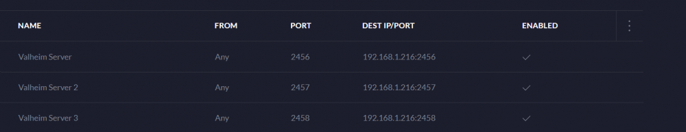

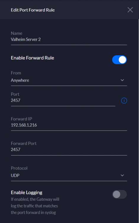

Wait, how does your Port Forwarding section look like that? I posted a screenshot earlier (I think on the previous page) and my Unifi page looks different than that.

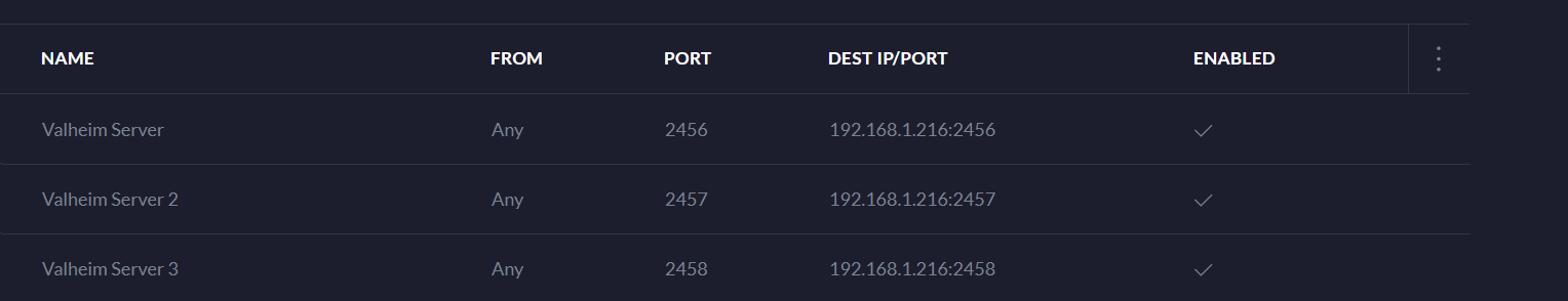

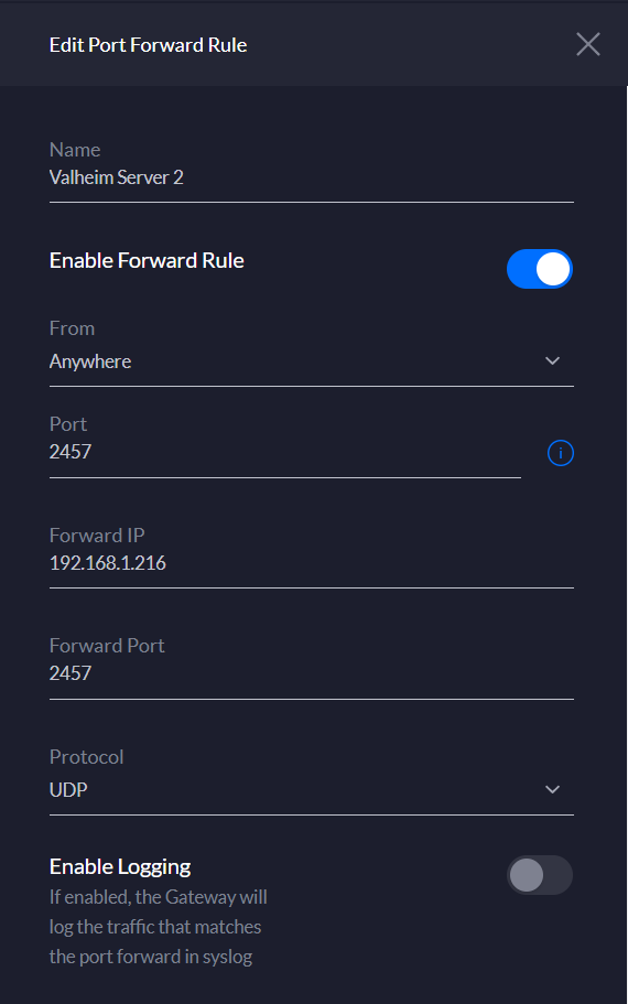

II have Google Fiber and they do not block ports. So yeah, I'm at a bit of a loss on what it could be. =\
Here is an image of what my Unifi's Port Forwarding page looks like: I'm also testing with my external IP by having a friend try to join. He is also seeing the not responding thing.
So I've been hosting a Valheim server for some friends on my Windows computer for a few days and it's been going well. I saw that there is now a docker container though and would like to switch to this. I just setup the container and I can join the game with my "localip:2457" but I cannot join with my external IP:2457". When trying to add "externalip:2457" to my Steam's favorite servers, it just says <not responding>. I have verified that the correct ports are forwarded on my Unifi router as well. Anyone else running into this issue?
