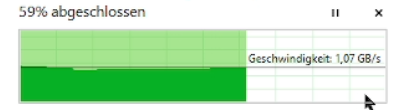

  5. Hi I have solved the Problem: ZFS Pool using unraid Cache Pool system: HP ML10v2 with 32GB ecc ram and Intel(R) Xeon(R) CPU E3-1271 v3 unraid stick 256 sata ssd 1 TB WD red nvme nas ssd disk1 is an 16gb usb stick - dummy drive - to start the array made zfspool with mirror of 2x 16TB I made an zfspool with 2 datasets via Console (you need zfs plugin) like this: root@media-server:~# zfs list NAME USED AVAIL REFER MOUNTPOINT zfspool 3.73T 10.7T 621M /zfspool zfspool/daten 546G 10.7T 546G /zfspool/daten zfspool/tausch 3.19T 10.7T 3.19T /zfspool/tausch FIRST start the array (first time: format disk1 AND format cache via GUI - I'm using xfs) now I mount the zfspool over disk1 so disk1 shows 16TB ! instead 16GB AND unraid Caching works great ! you need this: mount -R /zfspool /mnt/disk1 with -R also the Datasets are mounted ! this datasets are shown as user share in gui - and you can activate cache and smb (public) tausch and daten you need plugin: user scripts ! so every array start - the pool will mounted and on array stop it will unmounted mount -R /zfspool /mnt/disk1 - at startup of array umount -R /mnt/disk1 - at stopping ofarray so I get 1GB/sec (10gbit ethernet) with cache on - write 10gb video from windows 10 to unraid via SMB and ca. 250MB/sec without cache - speed of the toshiba 16Tb drives reading same --- ZFS speedup: creating log and cache files on the 1TB cache drive - I made 2 dummy files for ZFS ZIL/slog and cache/L2arc: dd if=/dev/zero of=/mnt/cache2nvme/CACHE/write bs=1M count=20480 - 20GB file dd if=/dev/zero of=/mnt/cache2nvme/CACHE/read bs=1M count=409600 - 400GB file now add this drives to your zfspool: zpool add zfspool log /mnt/cache2nvme/CACHE/write zpool add zfspool cache /mnt/cache2nvme/CACHE/read then it looks like this: -- zpool status pool: zfspool state: ONLINE scan: scrub canceled on Tue Jan 31 12:33:19 2023 config: NAME STATE READ WRITE CKSUM zfspool ONLINE 0 0 0 mirror-0 ONLINE 0 0 0 ata-TOSHIBA_MG08ACA16TE_31P0A1Z5F57H ONLINE 0 0 0 ata-TOSHIBA_MG08ACA16TE_31R0A13EF57H ONLINE 0 0 0 logs /mnt/cache2nvme/CACHE/write ONLINE 0 0 0 cache /mnt/cache2nvme/CACHE/read ONLINE 0 0 0 ----------------------- Greetings from Hamburg
