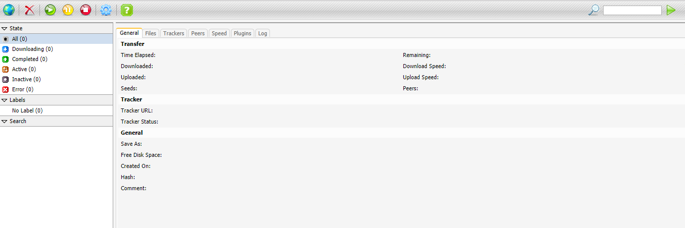

  3. Thanks for looking into it binhex. I tried all the steps, but it still didn't work. When I disabled the vpn, i could access the web ui though. After deleting the container and starting from scratch, I'm still getting the same problem with the rtorrent not starting, but this time i can access the ui even with the vpn enabled. The weird thing is that the plugins button has dissappeared, and also the portion that shows the torrent files. The appdata folder looks like this now with folders missing compared to this one before Anyway, I'll have a look again later on in case I have done something wrong, and wait to see if it worked for @doremi and @lastOne
