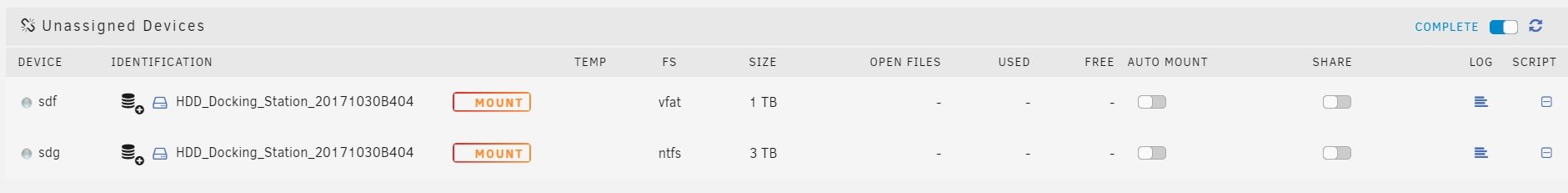

USB Docking Station not showing in Unraid OS but do in Preclear
Maybe I was just misreading. I had thought that USB drives would show in this version of Unraid, but I installed Unassigned Devices and I do see the two of them sitting there. Hopefully this means I can preclear them through this Docking Station.

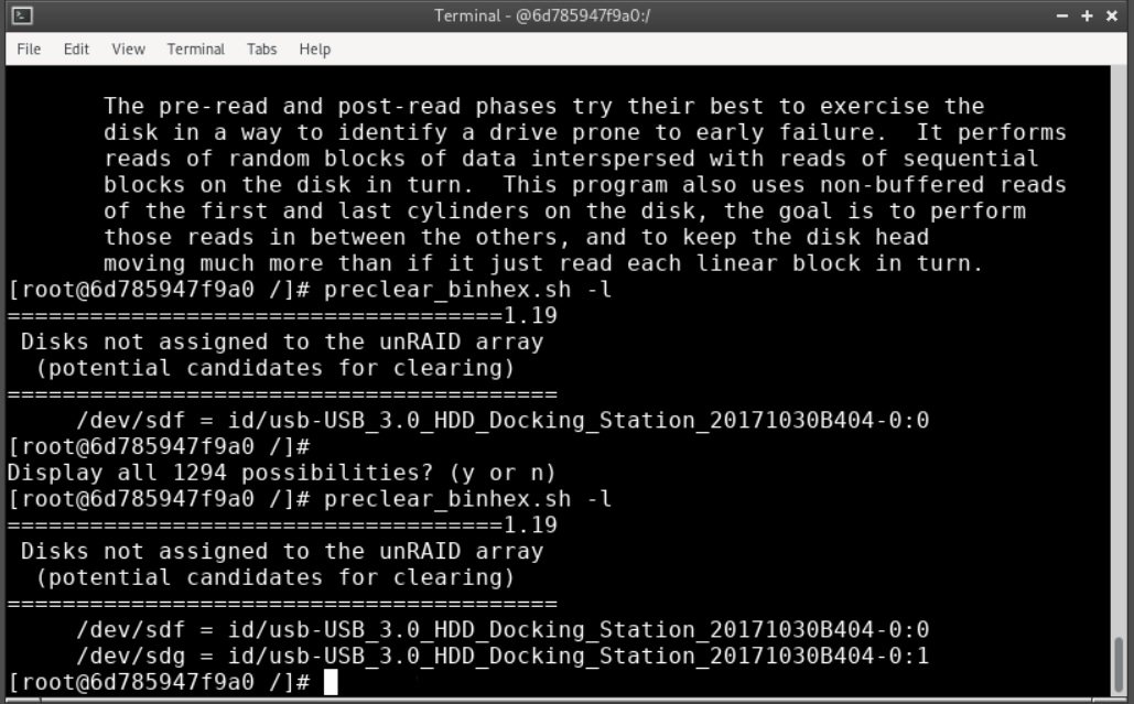

I was hoping to use this docking station I already had: https://www.amazon.ca/dp/B019DNBU7G/ref=sspa_dk_hqp_detail_aax_0?smid=A1ZAFAL1WND4H&spLa=ZW5jcnlwdGVkUXVhbGlmaWVyPUExNE9CQTkyRkU5TVlXJmVuY3J5cHRlZElkPUEwNDAwNTg4MTdJRzYxSkRMWTlXTSZlbmNyeXB0ZWRBZElkPUEwNTIwMzYyOUozNUpETEw5N0pQJndpZGdldE5hbWU9c3BfaHFwX3NoYXJlZCZhY3Rpb249Y2xpY2tSZWRpcmVjdCZkb05vdExvZ0NsaWNrPXRydWU&th=1 I want to preclear 4 drives I plan on putting into a new box I'm building along with the 3 in my existing small server. I put the first drive in the TARGET slot of the enclosure and its plugged in and on. I cannot see the drive anywhere in Unraid. During the process I also installed the BinHex preclear Docker to get ready and futzing with it using the -l function it does show the USB Docking Station as the only option to preclear because its not part of the array, so the box does know the docking station is attached and working, but it doesn't show the physical drive I have plugged into the station. Are dual slot stations like this just not suitable for preclearing drives? Or is there something I have to refresh in Unraid to get the unassigned drive to show? **During typing I also tried adding a 1TB drive I had around. In the screenshot you can see where I first only showed one USB Dock drive, now I do show two so I am assuming the preclear program does actually see the drives but can't translate the serial numbers to me? I have to know the SDF is Bay one and SDG is Bay two. Can I preclear the drives from this stage even though they don't show in the Unraid OS I am running Unraid 6.7.2.
