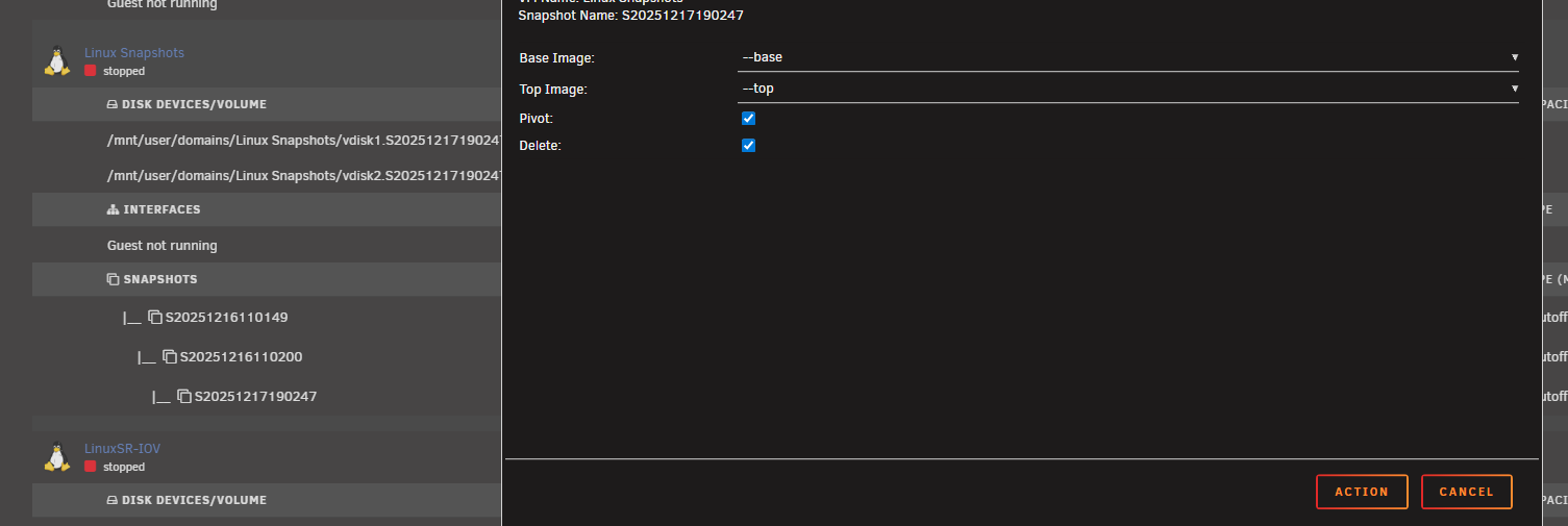

Is there any documentation or tutorial on Unraid 7 Snapshots?
You can run qemu-img info last_snap_file | grep backing and this will show the tree. You can use the flatten method as that is a solution that would be used to make a backup. The bug is just removing the snapshotdb entry for the gui if there are more than 2 snaps. Select on the last snap and commit using --base and --top this will collapse the whole tree back into the base image. root@computenode:~# qemu-img info /mnt/user/domains2/Arch9/vdisk1.S20250321211701qcow2 | grep backing backing file: /mnt/user/domains2/Arch9/vdisk1.img backing file format: raw root@computenode:~#

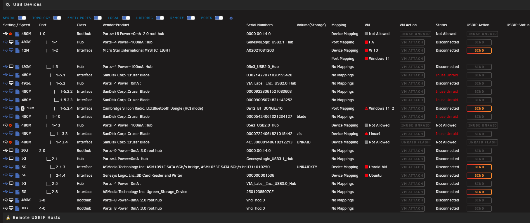

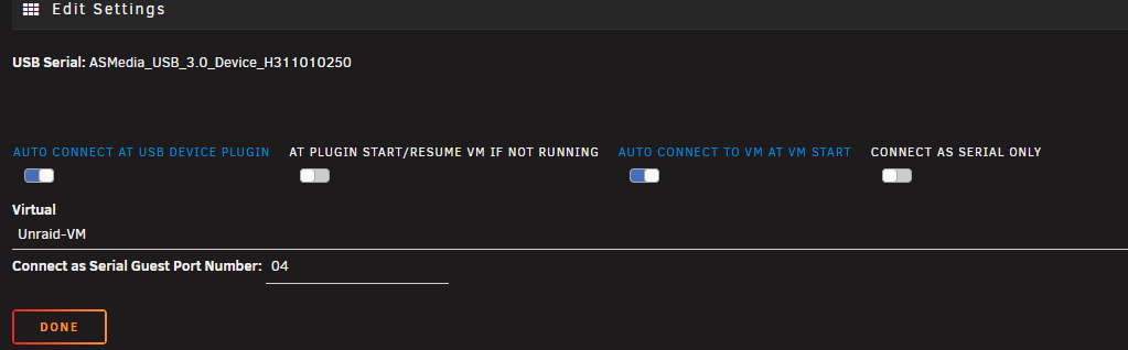

Help - On a VM, how to restore USB connection when USB printer is turned on after standby
On the menu line there is USB which will take you to Click on the second icon device mapping, first is port mapping. Then it will take you to the settings. Select the VM and enable auto connect at plugin and VM start. The printer will need to be active for it to show in the view.
Have a look at my USB manager plugin, you can remove from the VM template and it will add to the VM when it is active. You would create a device mapping for the printer and connect to VM at start and when connected.
When doing the commit select the last one if you want to commit all into the original you can leave the defaults. There is a bug I am working on that the snapshots in the GUI will leave info about the middle snapshot but it is just a ghost record in the snapshotdb file. base is the first image in the tree with top being the latest.
