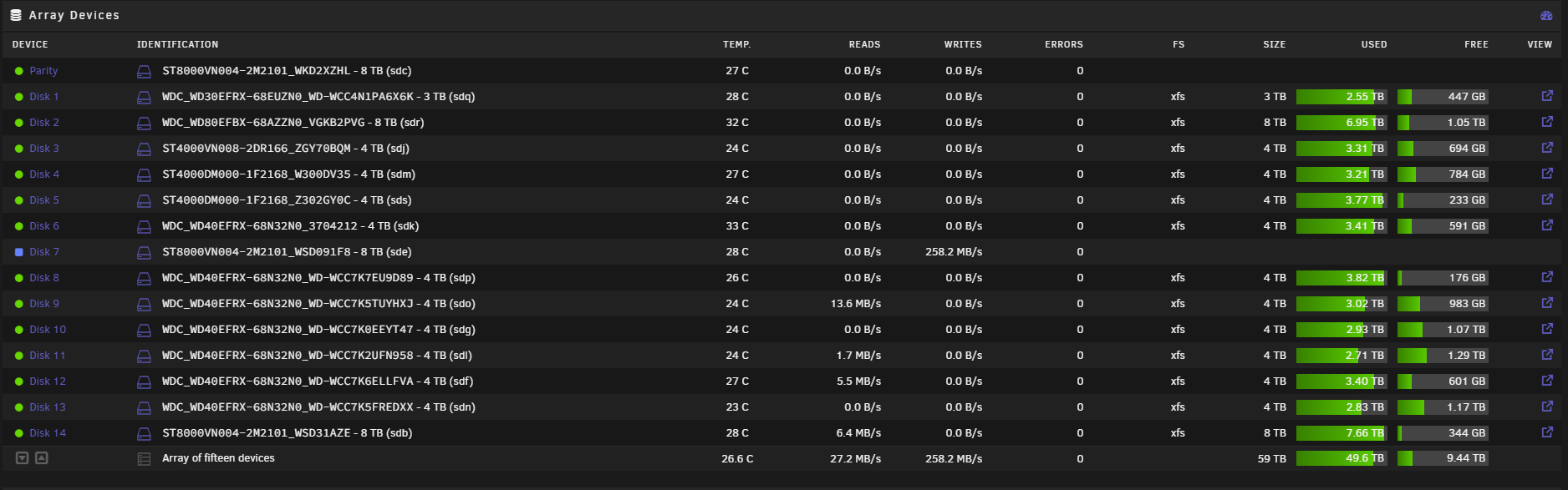

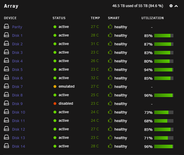

Rebuild UDMA Errors fixed SATA cable now in a weird state HELP!!

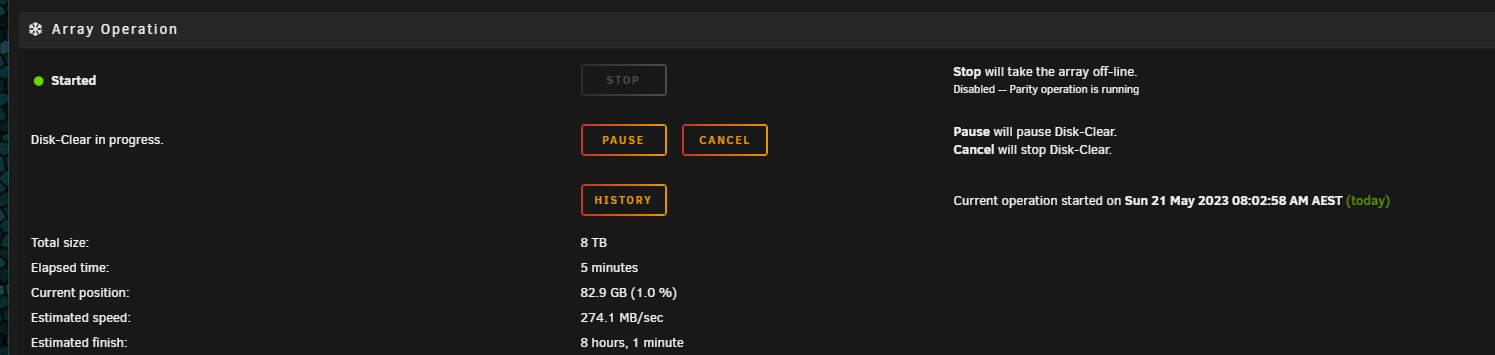

i managed to get Disk 9 back operational and marked the Parity as being correct but i can't seem to kick off disk7 rebuilding. its doing something not sure what it is doing though doesn't say. My data on Disk 9 looks good now just need to somehow bring disk 7 back to life.

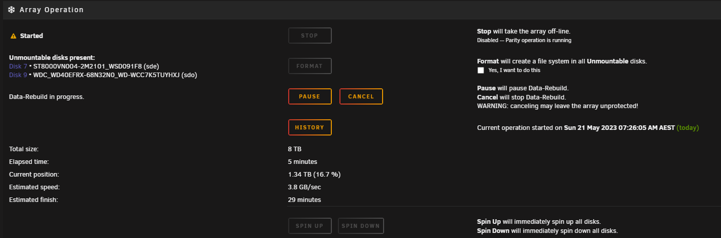

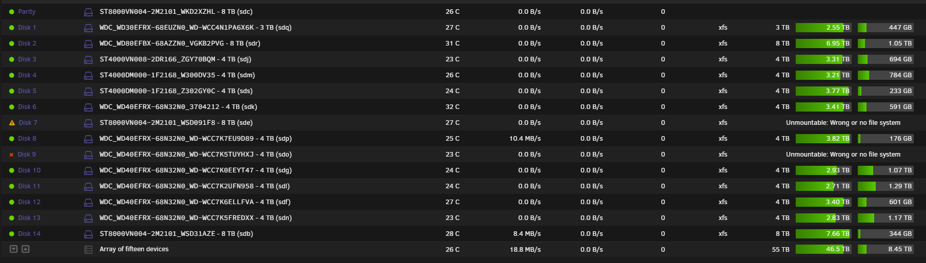

My disk 7 died so i RMA'd the disk and put in a replacement drive. it started Rebuilding and my disk 8 started throwing some UDMA Errors and it was going up in the hundreds so i shutdown my system. Replace my SATA cabling for Disk 9 when i booted it up i was shocked to see disk 9 is now disabled but i can see the temp on the disk. Starting the array i see this I am confused it is rebuilding but it isn't rebuilting. Not sure how to get disk 9 back online? How do I fix this mess?

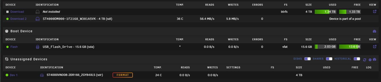

Replacing Secondary Cache Pool Disk
6.11.5
I had to change the second disk as Download then added in the new disk to Download 2 then it worked. Think it is just a UI Bug. Balancing Raid 1 now.
I have a second cache pool and one of the disks have failed in the pool set. I have a fresh installed disk to add to the cache pool but when i select the new disk it doesnt say it will be formated when i start the array so i haven't added it. Is there some other trick here? Only Download 2 survived in the cache pool the primary disk in the pool was the one that is dead.
