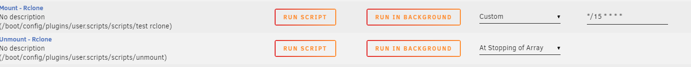

Hi all still having some random issue Full logs for this script are available at /tmp/user.scripts/tmpScripts/test rclone/log.txt /usr/sbin/rclone: line 22: 21762 Killed rcloneorig --config $config "$@" Script Starting Fri, 17 May 2019 17:20:01 -0400 Full logs for this script are available at /tmp/user.scripts/tmpScripts/test rclone/log.txt mkdir: cannot stat '/mnt/user/mount_rclone/google_vfs': Transport endpoint is not connected 17.05.2019 17:20:01 INFO: mounting rclone vfs. 2019/05/17 17:20:03 Fatal error: Can not open: /mnt/user/mount_rclone/google_vfs: open /mnt/user/mount_rclone/google_vfs: transport endpoint is not connected 17.05.2019 17:20:06 CRITICAL: rclone gdrive vfs mount failed - please check for problems. Script Finished Fri, 17 May 2019 17:20:06 -0400 Full logs for this script are available at /tmp/user.scripts/tmpScripts/test rclone/log.txt Script Starting Fri, 17 May 2019 17:25:01 -0400 Full logs for this script are available at /tmp/user.scripts/tmpScripts/test rclone/log.txt mkdir: cannot stat '/mnt/user/mount_rclone/google_vfs': Transport endpoint is not connected 17.05.2019 17:25:01 INFO: mounting rclone vfs. 2019/05/17 17:25:02 Fatal error: Can not open: /mnt/user/mount_rclone/google_vfs: open /mnt/user/mount_rclone/google_vfs: transport endpoint is not connected 17.05.2019 17:25:06 CRITICAL: rclone gdrive vfs mount failed - please check for problems. Script Finished Fri, 17 May 2019 17:25:06 -0400 Can someone tell me what should i do please thx Also in plex every media has a red trash what can i do ?

if i check my logs i always got this until i manually reset Script Starting Wed, 01 May 2019 18:50:01 -0400 Full logs for this script are available at /tmp/user.scripts/tmpScripts/test rclone/log.txt 01.05.2019 18:50:01 INFO: Exiting script already running. Script Finished Wed, 01 May 2019 18:50:01 -0400 Full logs for this script are available at /tmp/user.scripts/tmpScripts/test rclone/log.txt Script Starting Wed, 01 May 2019 18:55:01 -0400 Full logs for this script are available at /tmp/user.scripts/tmpScripts/test rclone/log.txt 01.05.2019 18:55:01 INFO: Exiting script already running. Script Finished Wed, 01 May 2019 18:55:01 -0400 Full logs for this script are available at /tmp/user.scripts/tmpScripts/test rclone/log.txt Script Starting Wed, 01 May 2019 18:58:05 -0400 Full logs for this script are available at /tmp/user.scripts/tmpScripts/test rclone/log.txt 01.05.2019 18:58:05 INFO: Exiting script already running. Script Finished Wed, 01 May 2019 18:58:05 -0400 Full logs for this script are available at /tmp/user.scripts/tmpScripts/test rclone/log.txt

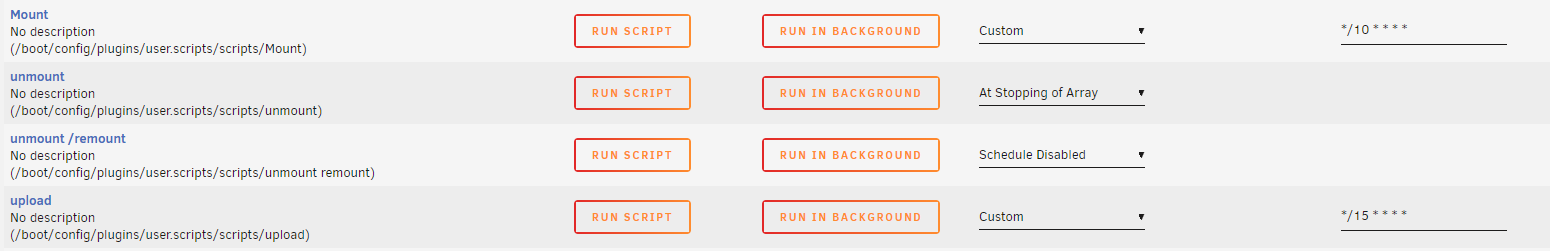

Did you experience anything like that ? The mount is dropping off a few thime a day since the upgrade. I did put 10 min but it always tell me that the script is running when its not really (the mount script)
