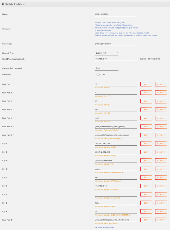

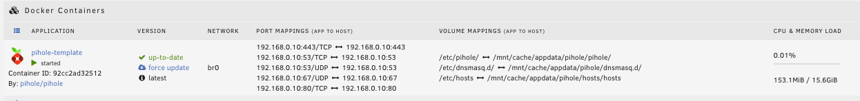

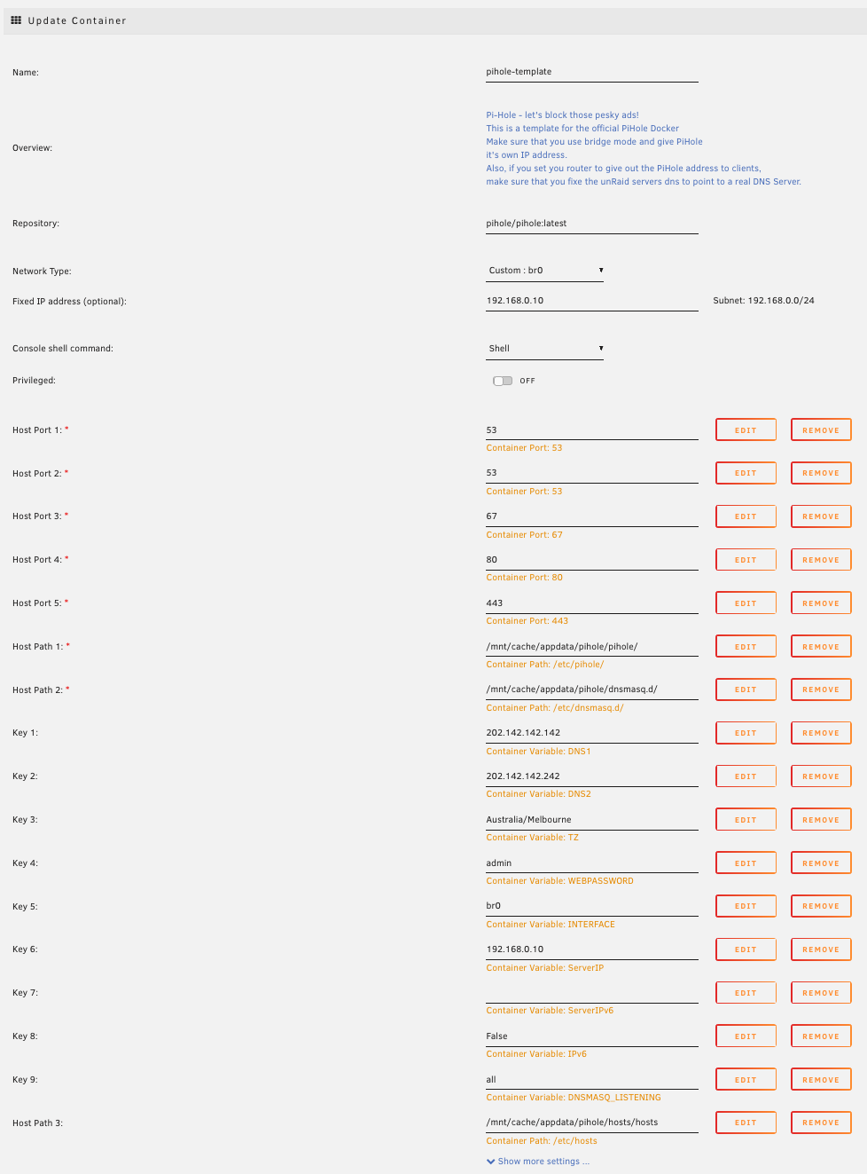

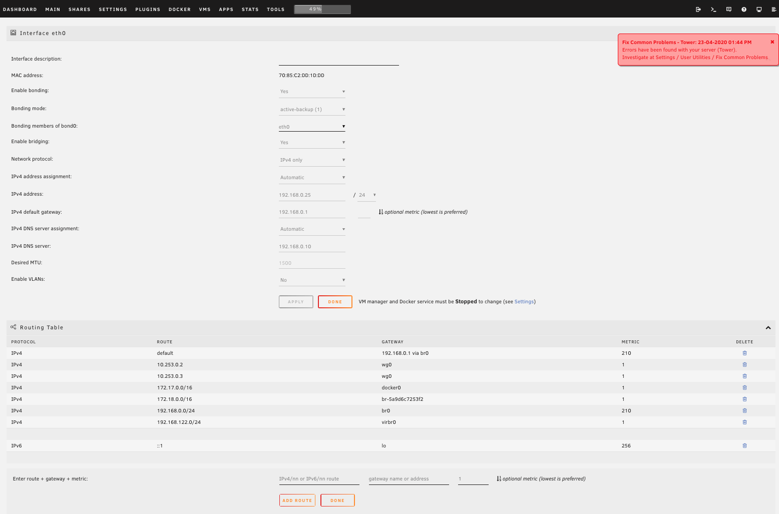

This worked brilliantly, thank you! Now I just need an easy way to sort out the hostname that PiHole shows for itself in the dashboard and I will be sorted! Edit: Spoke to soon! Every device on the network is going through PiHole just fine, however all the other Docker Containers + UnRaid are unable to get an internet connection. Anyone able to assist? I thought I had setup the network settings and custom: br0 correctly... * Unraid Server is: 192.168.0.25 * PiHole Docker is: 192.168.0.10
