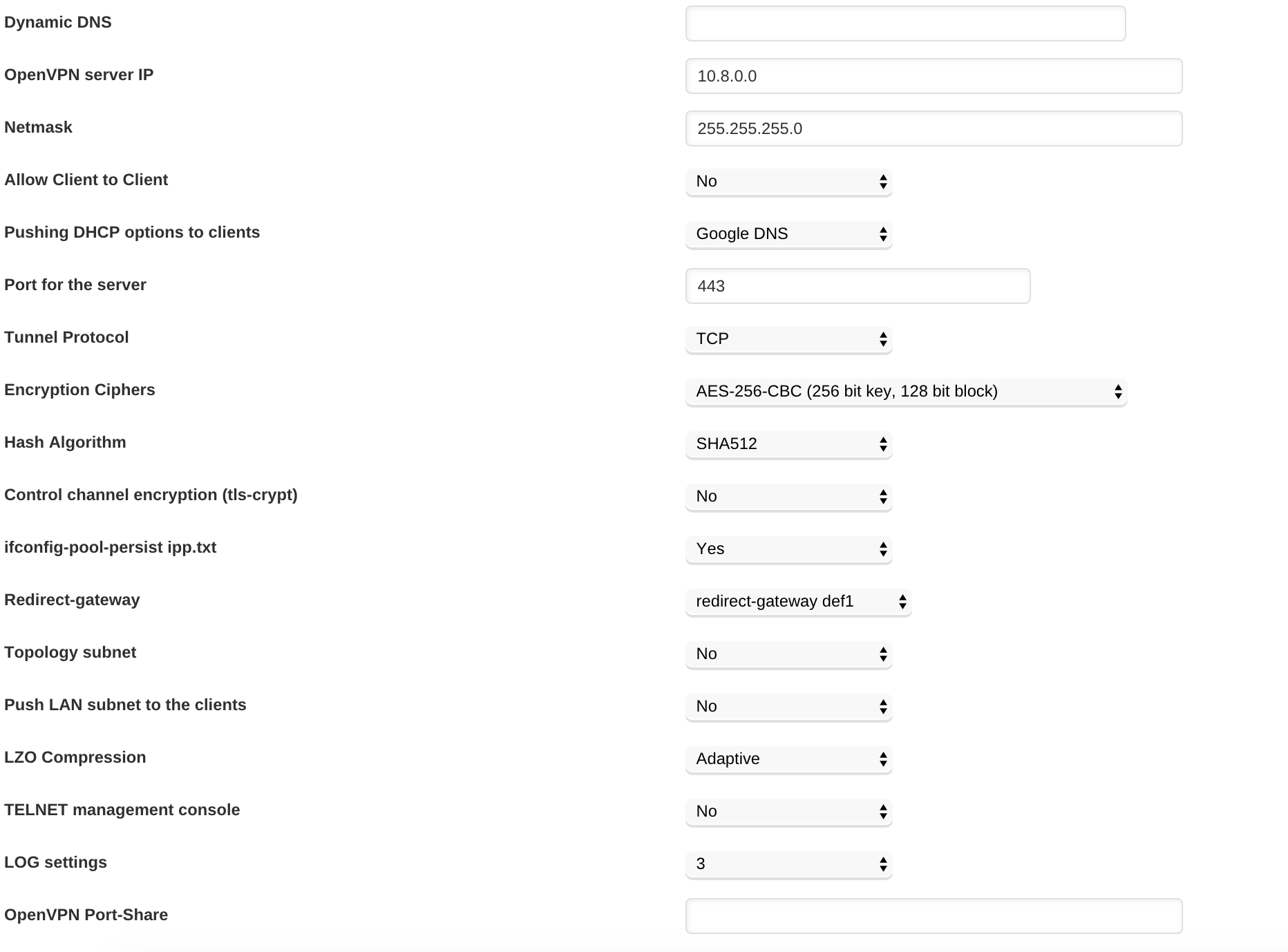

Hi, The error I get is as follows: 2018-02-02 20:59:28 MANAGEMENT: >STATE:1517633968,WAIT,,,,,, 2018-02-02 20:59:28 WARNING: Bad encapsulated packet length from peer (18516), which must be > 0 and <= 1627 -- please ensure that --tun-mtu or --link-mtu is equal on both peers -- this condition could also indicate a possible active attack on the TCP link -- [Attempting restart...] I have tried connecting from tunnel blick and the android clients. I attached my network and server configs. Thanks in advance! network.cfg
