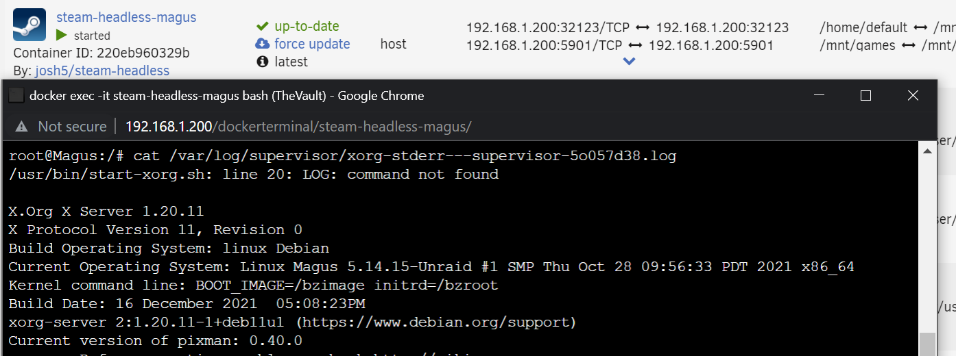

  7. It's not vnc that is the issue. It is the Xserver. Your other containers are running a framebuffer Xserver. But they do not support GPU acceleration. This container is running an X11 server that supports your GPU, so it needs exclusive access to that hardware. If anything else is using that hardware, it will not start. When you show me the X server log I'll have a better idea. Take a look at the logs in /var/log/supervisor

  10. Is xorg starting?

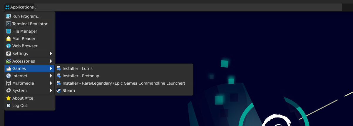

  22. In order to keep the Docker image size below 3GB, I've decided to roll out installer scripts with the image. You can initialise these from the menu under Applications > Games. These installers will generate a installation script that will live in ~/init.d/* and will be executed on container startup. If you update the container image or modify the template settings, the install scripts will re-install the various applications next start of the container.
