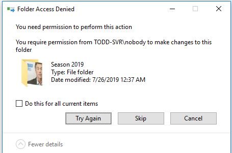

I've had some earlier posts, about the permissions granted for files that are generated by the Plex DVR using the LinuxServer.io docker. I started a new thread in the general forum looking for more help on the subject : https://forums.unraid.net/topic/82188-file-permissions-issue-with-plex-docker-linuxserverio/?tab=comments#comment-763917 I've had some help there and the most likely issue is the UMASK variable and I'm posting the basic info here so someone can look into a permanent fix. This would only be a problem for someone using the Plex DVR feature and then also wanted to be able to move or delete files that have been created by Plex. I know you can delete files from inside Plex, but 1. I dont want anyone logged in on a TV in my house to be able to make that mistake, and 2. There would still be a host of files and directories that can only be modified by plex, unless the "new permissions" utility is run. There is a lot more information if you go follow the thread in that link, but here are the highlights: Here are the permissions shown using the ls -al /mnt/user0 command: This folder was created using the Plex DVR drwxr-xr-x 1 nobody users 33 Jul 30 20:05 Bxxxxxg\ (2019)/ a similar folder that was created from the old plex (Limetech docker) DVR reads like this drwxrwxrwx 1 nobody users 52 Mayt 15 22:31 Bxxxxxxx\ (2017)/ His comment was: The umask 0000 needs to be called in the docker after the filesystems are created - in whatever entrypoint script is being used. I'd file this as a bug with the LS.IO guys on github or in their support thread. You can readily prove that the UMASK isn't being set properly; EDIT: attached is a screenshot of the file/folder stats created by the Plex DVR. I hope this is enough to get something going. If this is incorrect and the UMASK setting is correct already please let me know.

to be clear, the only files I"m having issues with are files the Plex DVR creates. For some reason they have permissions restricted to the user "nobody"... I dont think Plex actually uses "nobody" I think its a blank in the file when it's created so unRaid is calling it "nobody." I also dont think this is due to the Plex update, I remember having this when I first started using the Plex DVR. I can't recall what was done to get over the issue, it was a couple years ago.

My windows user is same user/pw as the administrator on the unRaid machine. It should have read/write to everything. However it doesn't have permissions to the DVR movies that Plex creates until I run "New Permissiosn" Odd, but I can't figure it out.

yes that works, but I have to do it every time. There has to be a way to stop it from creating secured files.

Yes, it works. I'm guessing because unRaid is seeing Plex as the user "nobody" and but not seeing me as "nobody" when I'm trying to delete from my PC. (see image). The question is why are the files restricted to "nobody" for write/delete access?

So the only outstanding issue is Plex DVR recordings having restricted permissions so I can't delete them without first running "new permissions"

So last night I migrated over to the Linuxserver.io docker from Limetech. Everything came up just as I was looking for. However, I have one issue, and one question.... Issue: Any DVR recorded file is being setup with the username "nobody" and I can't delete any of the video files created until I run the "new permissions" utility. This happened once before I can't for the life of me remember what I did to fix it. (see image) Question: How do I confirm where transcoding is taking place (temp folder)? In the Linuxserver.io docker settings it is set to mnt/user/transcode... The "Transcode" is on my cache disk only. Inside Plex, the transcoder settings originally had \\cache\transcode. When I first tried to record after the new install, I was out of space errors. The \\cache\transcode would seemingly be a bad pathway, I can't recall when I plugged that in and it must have been held over from the old setup. However, it was working previously. I deleted that pathway in the Plex transcode setup, and the errors went away. Here is the question: Where is it transcoding to? With the actual plex software transcode location blank, is it respecting or using the location designated in the docker? I do want it using the cache drive for transcoding, there is plenty of room. Thanks in advance for any help.
