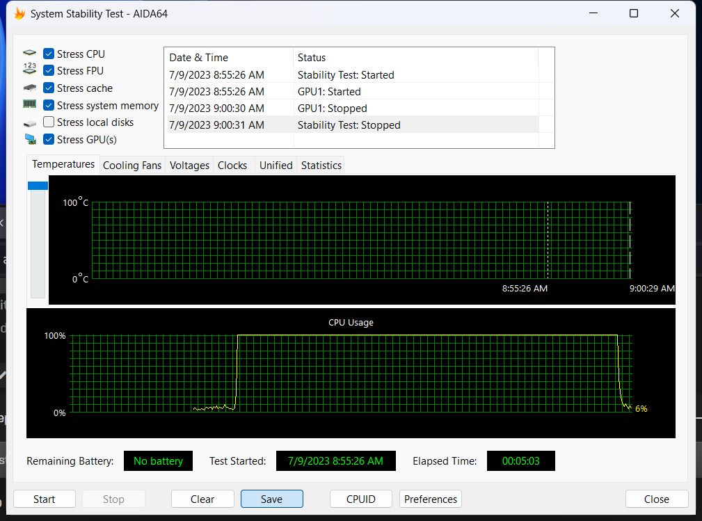

  9. Update: After reboot I restarted the Windows11 VM up and decided to run AIDA64 stability test on both CPU and GPU. Ran two 5 Min tests (see attached) and 1 min after that was done system crashed. I also put the PCIE setting back to AUTO in the Bios. After the new upcomming crash I will try installing a NVIDIA GPU and see what happens. Thanks,
