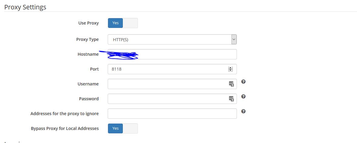

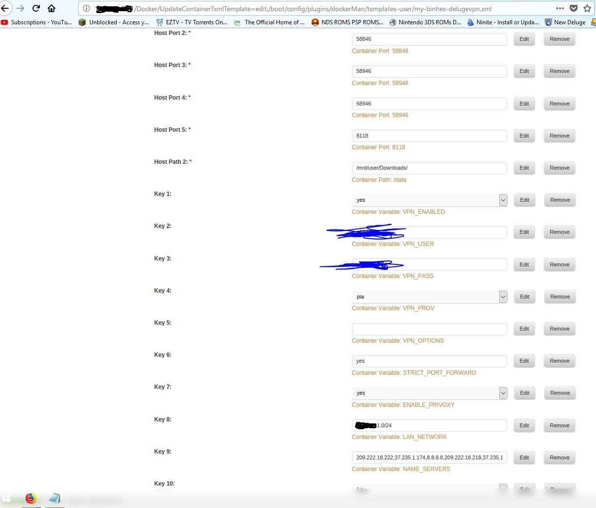

  2. I changed the 1.0/24 to the what I assumed was correct 0.0/24 like in the unraid iP and I cannot connect to the deluge web ui. This is why I am so lost on this. Sent from my SM-G950U using Tapatalk

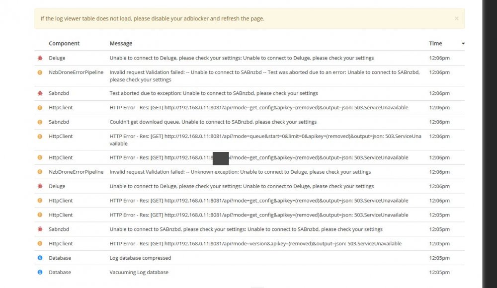

  3. 192.168.0.11 is what I have. I connected and tested each connection everything worked fine, then I turn the proxy setting on with the settings posted above and retested deluge and sab and they both will not connect Sent from my SM-G950U using Tapatalk

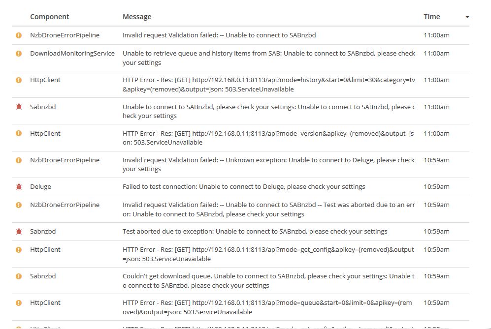

  5. yea I have it set as 8118, I was screwing around with different ports to try to get it to work that's why the 8113 was there. I can access each web UI for each container and they all connect and work fine till I try to use the proxy setting in sonarr/radarr.
  6. i tried it through both because i couldnt get the deluge one to work. at first i had the delugevpn as the only one running with sab with vpn disabled and privoxy disabled, then switched and tried sab

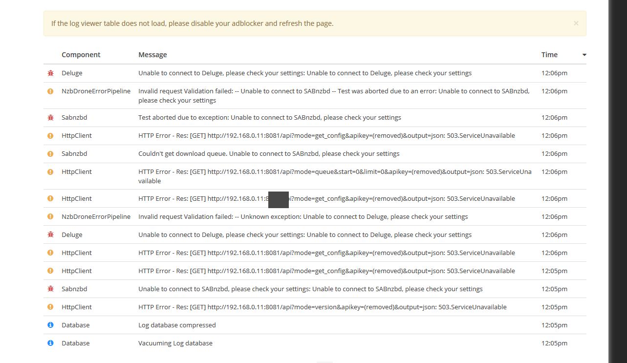

  7. Hi, I'm Having trouble connecting sonarr through the delugevpn proxy I followed spaceinvaderones video multiple times. Everything works as it should except when I try to run sonarr through the 8118 port proxy. any help would be greatly appreciated this has been racking my brain for hours.
