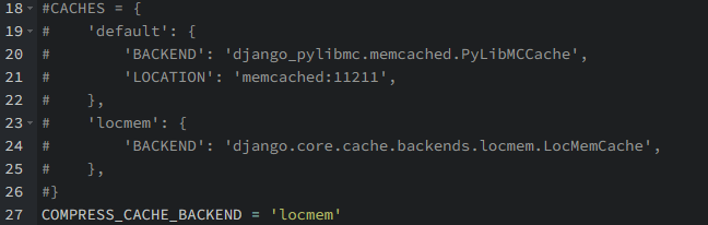

Just to recap the events and issues: 1. The first run admin credentials issue was fixed, this allows the user to login with the supplied credentials. Previously this was not possible. 2. The memcached docker requirements IS still an issue. If memcached is not installed or part of the seafile-net custom docker network you will get "Page Unavailable" errors if you do any action in which may throw an error. For example, log in with the wrong credentials. To fix the #2 issue the user either needs to remove the CACHES{} backend from the seahub_settings.py config file OR install memcached and include it in the seafile-net docker network.

Confused about Seafile Container versions & updates
Now that the admin login is fixed im going to test out a fresh install to see if the memcached thing is still an issue. Ive removed as well to test. Test complete: it appears it was just the admin email/password issue, not memcached. Edit 2: However, if memcached is not configured, instead of getting the "Invalid Login" page, the user is instead presented with the "Page Unavailable" screen. This would explain the behavior I expereinced because I could not login due the admin/password bug. The two options to remedy this are to either install memcached and add it to the seafile-net docker network OR to remove the CACHES {} portion from the seahub_settings.py (setting it to localhost does not fix it)
