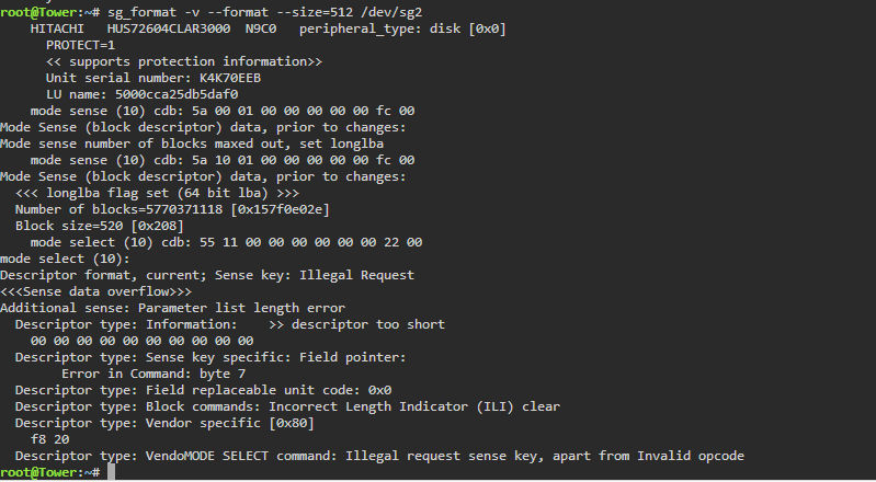

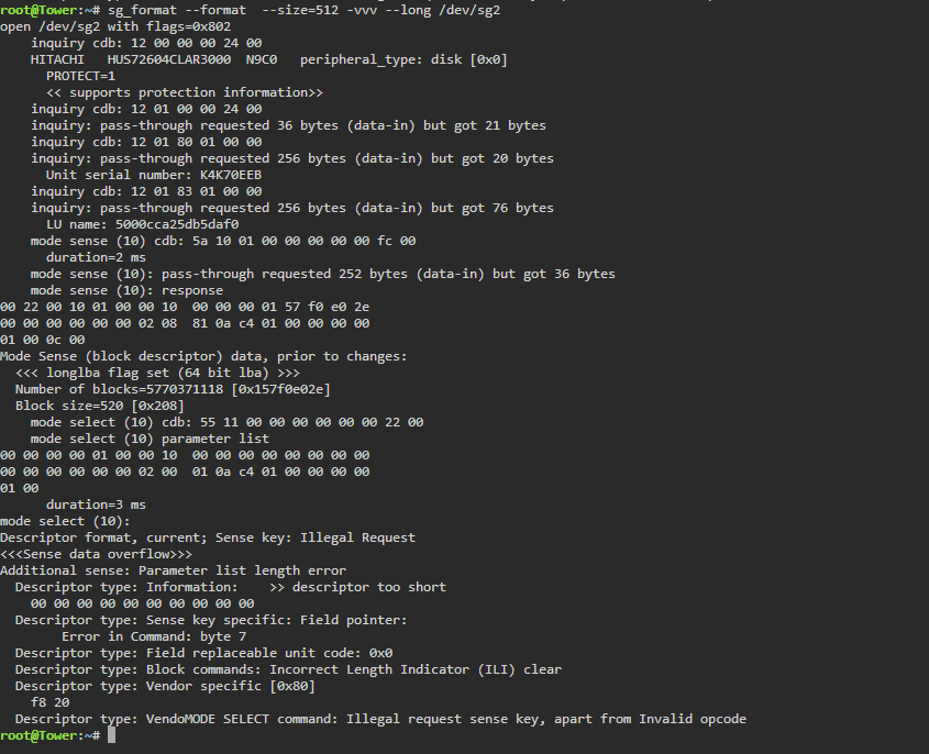

  4. HGST HW 0F22941 Hgst Ultrastar Hus726040als210 SAS is the drive i have , i will check teh byte size later , i only have the machine running unraid so cant check in windows.
  5. Thankyou this has worked apart from the fact the drive i have is 4tb and its been formatted to 3tb?
  6. Thanks , i dont seem to be able to find the compiled version or the app?
  7. Any help would be appreciated , i'm sure its a parameter missing or something i'm not doing correctly?
