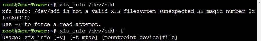

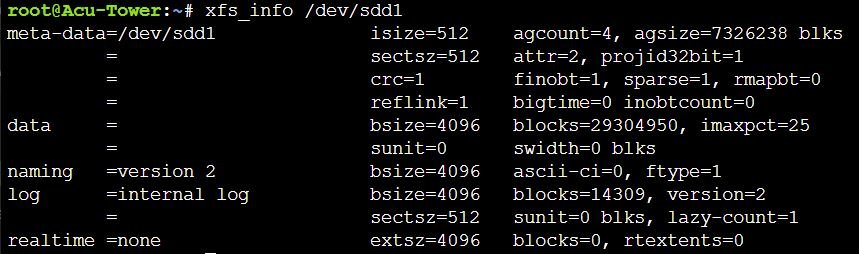

  12. Yes true reflink is enabled but veeam reports disable. Some idea?
  13. Hi, I have a problem after setting up veeam backup. My log is still filling up and I'm already 55% full. Does anyone know what could be the problem?
