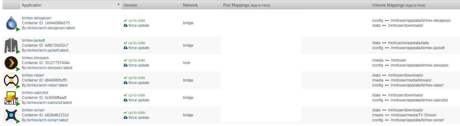

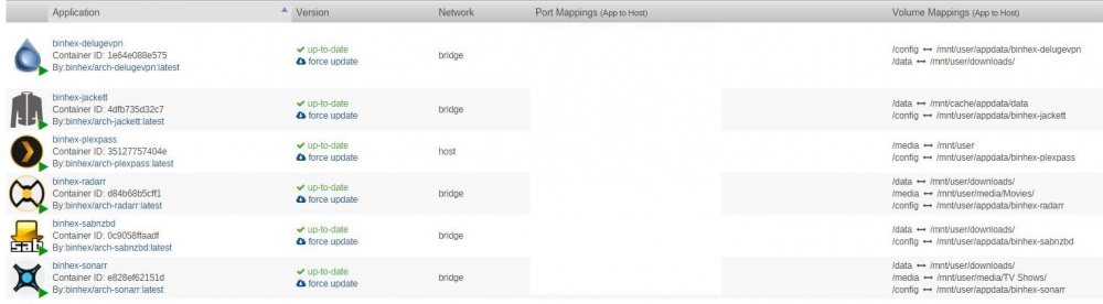

  16. Hi, thank you for the response. I don't think there is anything wrong with my volume mappings (see below) SABnzbd works perfectly and is set up exactly the same way that DelugeVPN is, however, DelugeVPN won't label, or allow for things to be renamed and moved.
