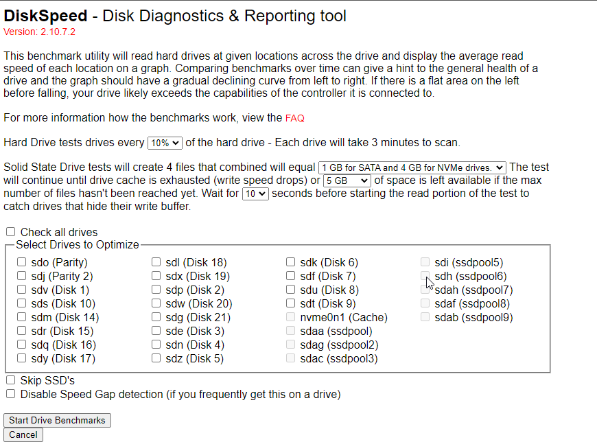

  13. I'm trying to do a benchmark on an ssd but all the ssds are grayed out. Any idea why?

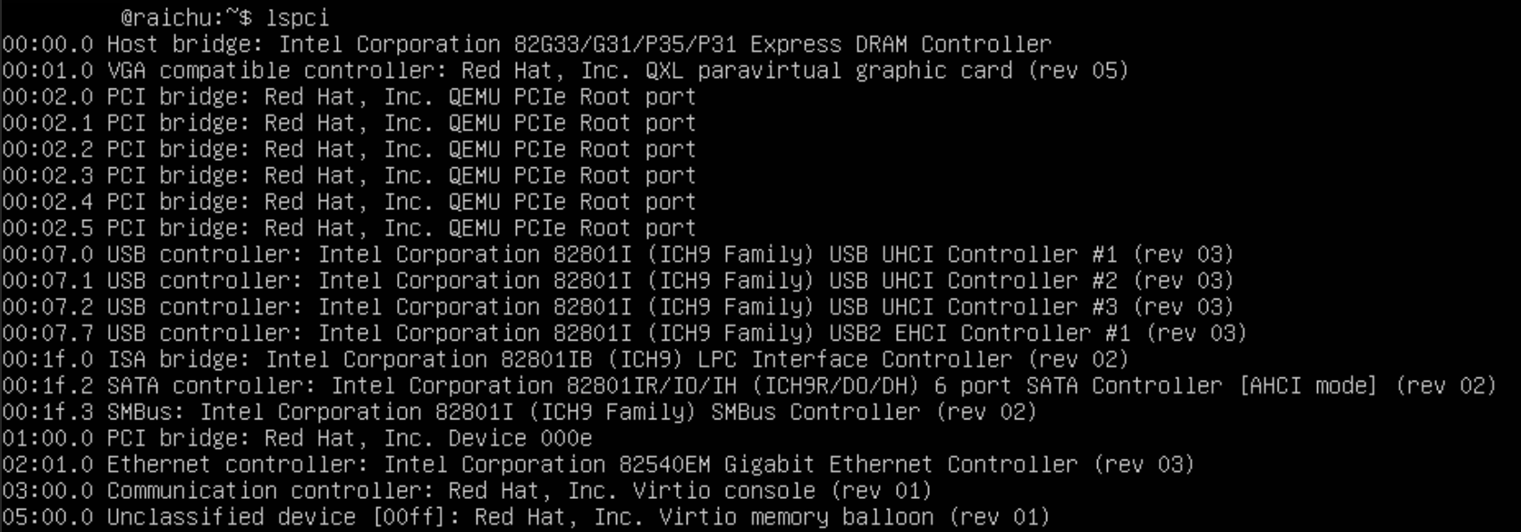

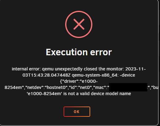

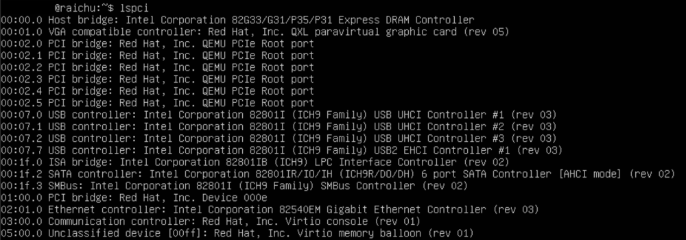

  16. Apologies @ghost82 -- I gave you a diagnostics from a bit earlier. I only have the e1000 as an option from the drop down. I can start it with the following but no network: <interface type='bridge'> <mac address='52:54:00:9e:3b:8c'/> <source bridge='br0'/> <model type='e1000'/> <address type='pci' domain='0x0000' bus='0x07' slot='0x01' function='0x0'/> </interface> but with the following it fails to start showing the error in the screenshot below. <interface type='bridge'> <mac address='52:54:00:9e:3b:8c'/> <source bridge='br0'/> <model type='e1000-8254em'/> <address type='pci' domain='0x0000' bus='0x07' slot='0x01' function='0x0'/> </interface> I started it with it set to e1000 and posted the lspci you requested -- the screenshot is below. Thanks again for your review. pumbaa-diagnostics-20231103-1151.zip

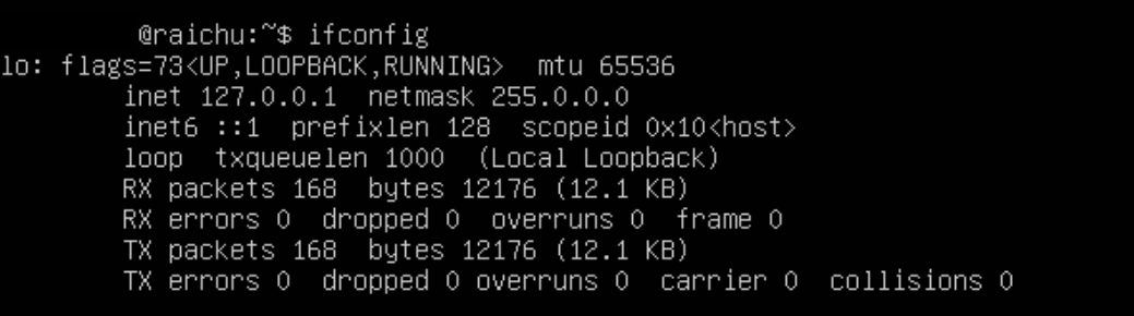

  20. seems like no matter which option I use, this is all i get back. It doesn't have any visible eth interfaces. And sorry for the spam.
