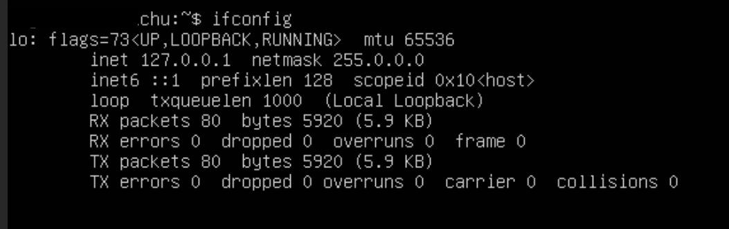

  1. virtio to sata for the disks does allow the VM to start up I believe I tried all the different network options and none of them actually gave me a network.
  2. Thanks. The issue with even attempting to update the kernel inside the VM is that the network also uses virtio it seems and I can't get that to work either...so no internet. More details on this thread. Appreciate the response.

  5. After upgrading to 6.12.4 from 6.11.5 my ubuntu VM is no longer able to load the os when using virtio. I switch that to sata and then I can get to the OS via VNC but the virtio network still doesn't seem to work at all. I have tried several different network configs to get it to work but none are working. I am currently back to the way it was prior to the upgrade. VMName: Raichu -- VM settings are contained in the diagnostics bundle. Attaching details pumbaa-diagnostics-20231101-1636.zip
