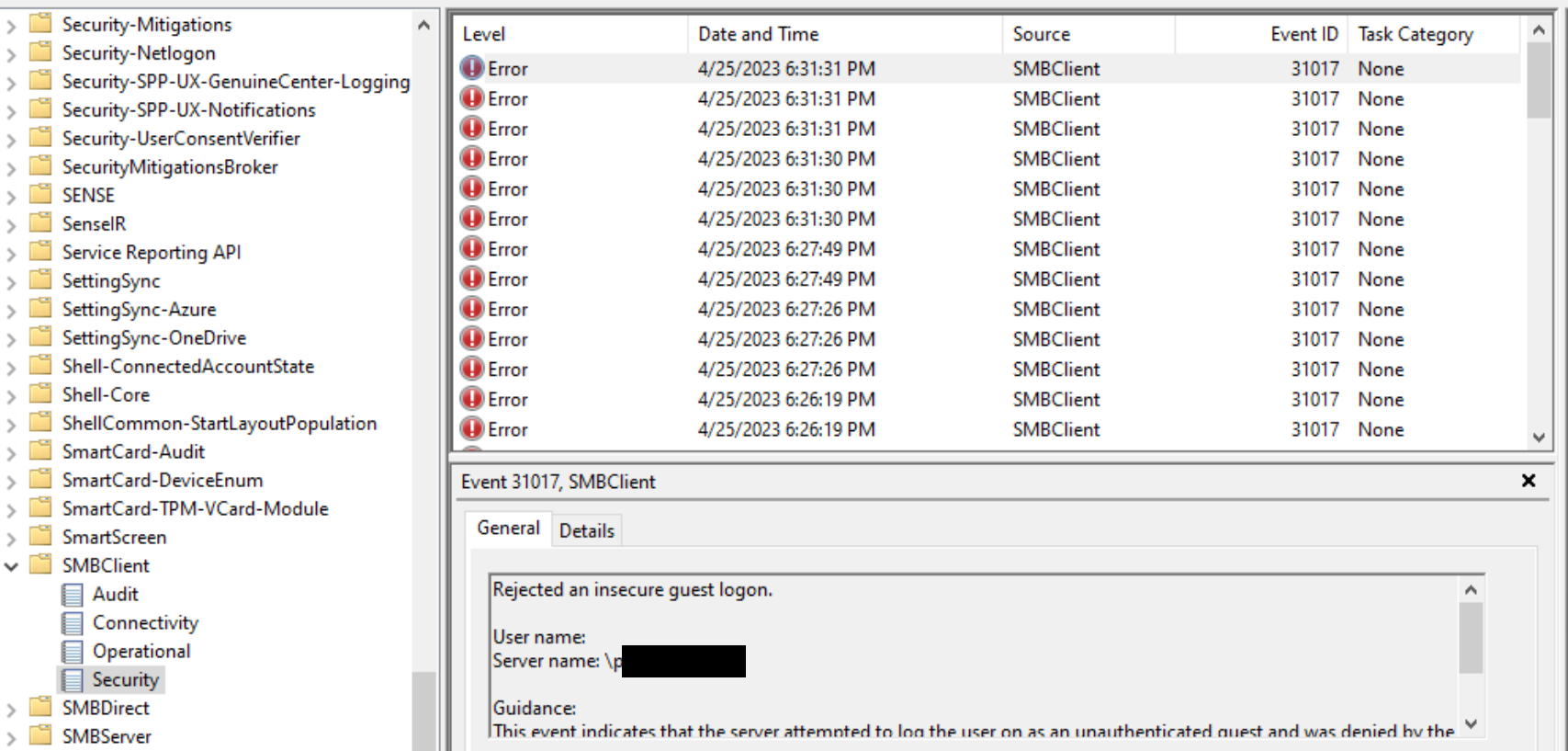

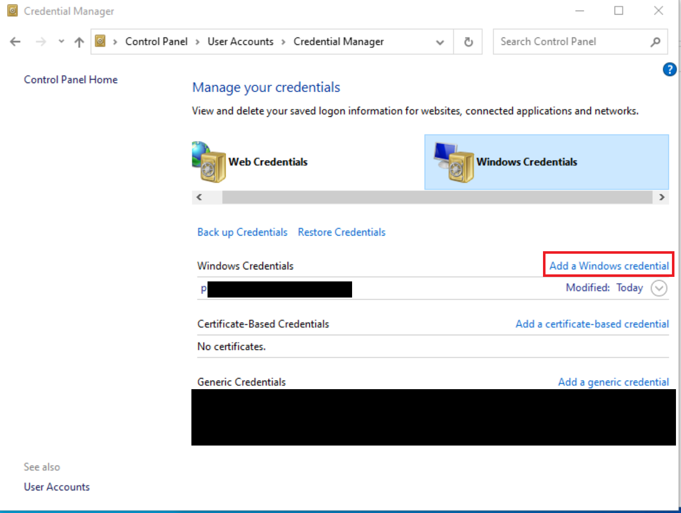

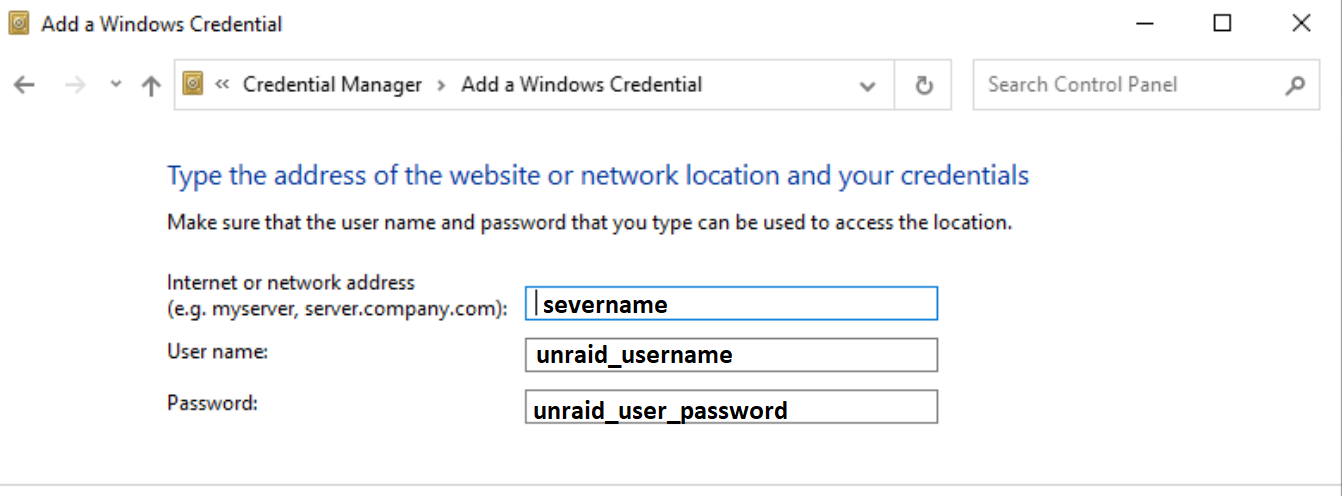

  1. UPDATE -- The above only works until you restart -- to make this permanent add a windows credential start --> credentials manager --> add windows credential
  2. So after digging through the Windows service event logs I found out that Windows Explorer was continuing to try to login as an "unauthorized guest user". After a little more digging I found out how to provide a username password (the unraid share creds) open cmd and type the following net use \\server\share <<password>> /USER:<<USERNAME>> Now open up windows explorer and viola. This problem does only present itself after the update referenced above I did a few fresh installs and went through all the updates and after that update it always broke. Hopefully this can help someone else.
  3. Thanks @Frank1940 -- I will go through the PDF -- note that I have two other Windows machines one the network and I've checked -- that update was installed on those PCs as well and those are working fine. This is very strange because this VM is Win 10 and it fails with the update installed and works when I uninstall it. Very strange. I will keep investigating and report my findings. Thanks for your response.
  4. After Windows installs kb4023057 -- the //SERVER and all shares are no longer accessible. I uninstalled the update and restarted and it worked again. Just wanted to bring this to developer attention. It seems like Windows only let's me pause updates for 35 days so I know I'm good for 35 days but avoiding this update is not a long-term solution. Is this a known issue? Is there a fix? If you need additional logs / details from windows machine after the update -- I can reproduce the issue be reinstalling the update and give you what you need, I'm pretty technical so I should be able to provide additional details if you need them. Thank you.
