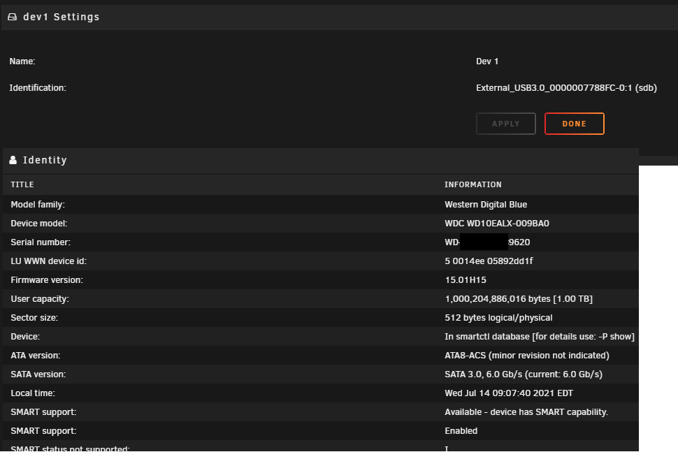

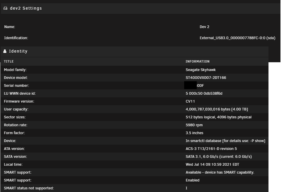

Gotcha, thanks for that. I took a look and did notice a subtle difference between the two disks showing up. Perhaps some logic can be added to UD to enable more devices? This is what shows up for the USB enclosure root@pumbaa:/dev/disk/by-id# ls | grep USB usb-External_USB3.0_0000007788FC-0:0@ usb-External_USB3.0_0000007788FC-0:0-part1@ usb-External_USB3.0_0000007788FC-0:1@ usb-External_USB3.0_0000007788FC-0:1-part1@ I'm not sure if there's any other way to identify the disks other than by-id but just thought I'd share what I found in case there's an opportunity here. For now, I suppose I will return this enclosure and try another one. Thanks again for the assistance.
I see that the device is appearing multiple times but why is UD not capable of grabbing the disk metadata. When I click on the dev, you can see from my screenshots that the disk metadata is available. Not trying to be complicated just curious as to why if Unraid is able to see the Serial Numbers, UD cannot? Is there a way to fix this? Thanks
Thanks, I recorded a little 2m video so you could see what's happening. I click on the dev to see the disk details and I am seeing the correct serial numbers. See images attached. Just trying to be 100% sure that the enclosure won't work before I go and exchange it because I had another version of this exact same brand and it's been working for years. One last note, I did have one of the disks shared in the previous enclosure and I do have a docker that references the cctv mount point...wondering if there's something cached somewhere that is messing up UD.
How can I confirm? I can see the serial number and model numbers when I click on the disk link. lsblk also shows them as different devs and diff partitions and even when both are mounted the partitions are mounted at /dev/sbd1 and the other is /dev/sdx1.
