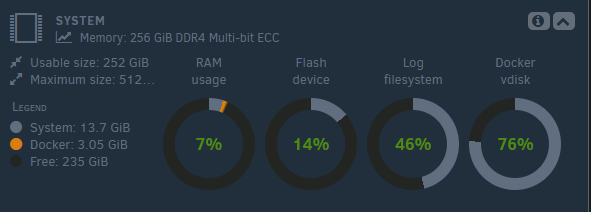

  15. Well I finally got a chance to look into this. I have 4 nvme slots on my board and 2 nvme drives in a cache pool. I pulled both drives and installed heatsinks on them because every so often when the mover was running one of the drives would hit 50-60C and I didn't like that much. (I think it was the drive that was erroring, but i'm not sure) Originally the drive with the errors was in slot 0, and the 2nd drive in slot 1. When reinstalling the drives i put the drive with errors in slot 2, and the 2nd drive in slot 0, leaving slots 1 and 3 unoccupied. I'm still seeing the errors and they've followed the drive.... Some google research seems to indicate this is a harmless error - BUT in a week or so, log folder will fill up and I'll need to delete the syslog.1 or reboot. Any suggestions besides seeing if Samsung will replace the drive?
