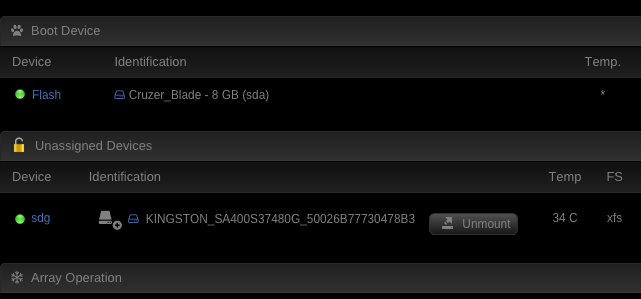

Holy S**t! You were right! When using color bar to show the usage, this lines appear. When using gray bar or text, no issue! Thank a lot!
@dlandon, tried what you proposed, but the outcome was the same! Same error. Thanks, nas-diagnostics-20180316-0953.zip
Good morning @dlandon As requested, I'm bringing my issue to this topic. "Did anyone ever got this problem below? I tried updating to the latest version, rebooting and reinstalling the plugin. This error appears only when I mount any drive. Thoughts? Thank you!"
