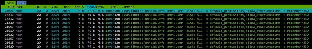

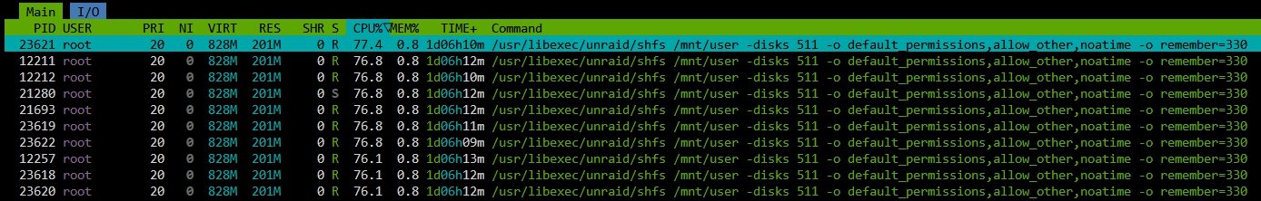

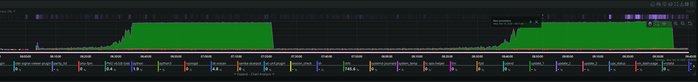

  2. I didn't think so, but turns out I have Rclone (mirrors my Google Drive for backup) scheduled for around that time. I ran lsof | grep /mnt/user this morning while the CPU usage was high and seen it backing up a bunch of files with huge files paths due to what looks like a Google Drive sync error ie Parent Folder/Folder 1/Parent Folder/Folder 1/Parent Folder/Folder 1 x 100 😑 Ive disabled Rclone and will report back tomorrow, but I'm hopeful I've found the cause.
  3. System Mother Board: Gigabyte B760M WIFI DDR4 CPU: 12th Gen Intel® Core™ i5-12500 Memory: 24GB DDR4 GPU: No GPU Hard Drives Cache: Crucial/Micron Client SSDs 480 GB SATA 3.3 Parity: No parity Array Disk's: 8 x 4TB (mix of WD and Seagate) Ive been experiencing an issue for the last month or so where I see 100% CPU usage by SHFS. Ive been keeping an eye on it with Netdata and it starts and stops at exactly the same time each day, 3 x 1 hour sessions approx. A couple of points Ive noted during these CPU spikes, Minimal / NIL CPU usage by any dockers Minimal / NIL disk usage showing on the Unraid dashboad, either in numbered reads/writes or B/s I set the Appdata and Downloads shares to Cache exclusive already, this seems to be the only suggestion I could find when searching previous threads. I plan to update the BIOS today. My Unraid knowledge is fairly limited but any suggestions would be greatly appreciated 🙂 I can export Diagnostics if required.

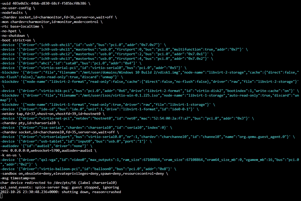

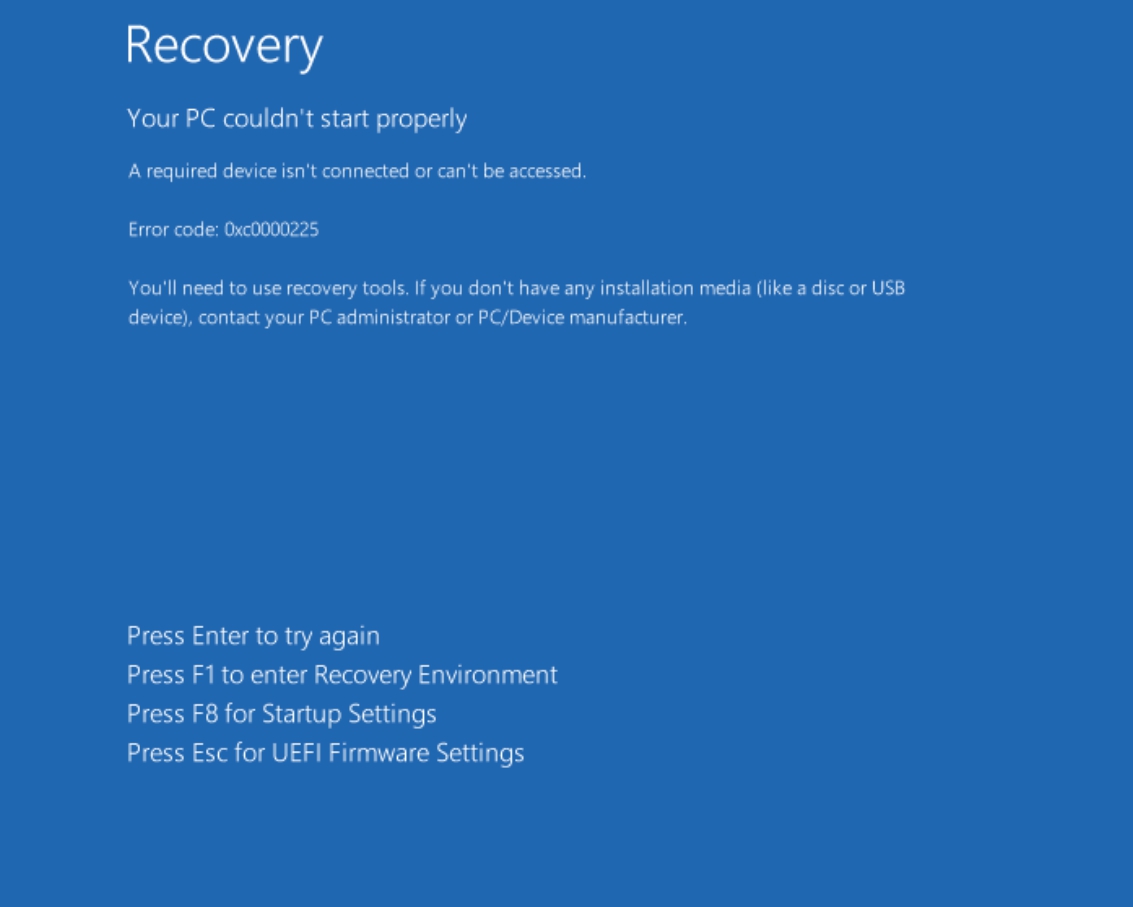

  4. Hoping I can use this thread to get some help. Neither of my VMs (W10 & W11) will boot after upgrading to 6.11.1. They firstly crash, but I can get them into the Windows recovery screen by attempting the boot again. Thanks in advance
