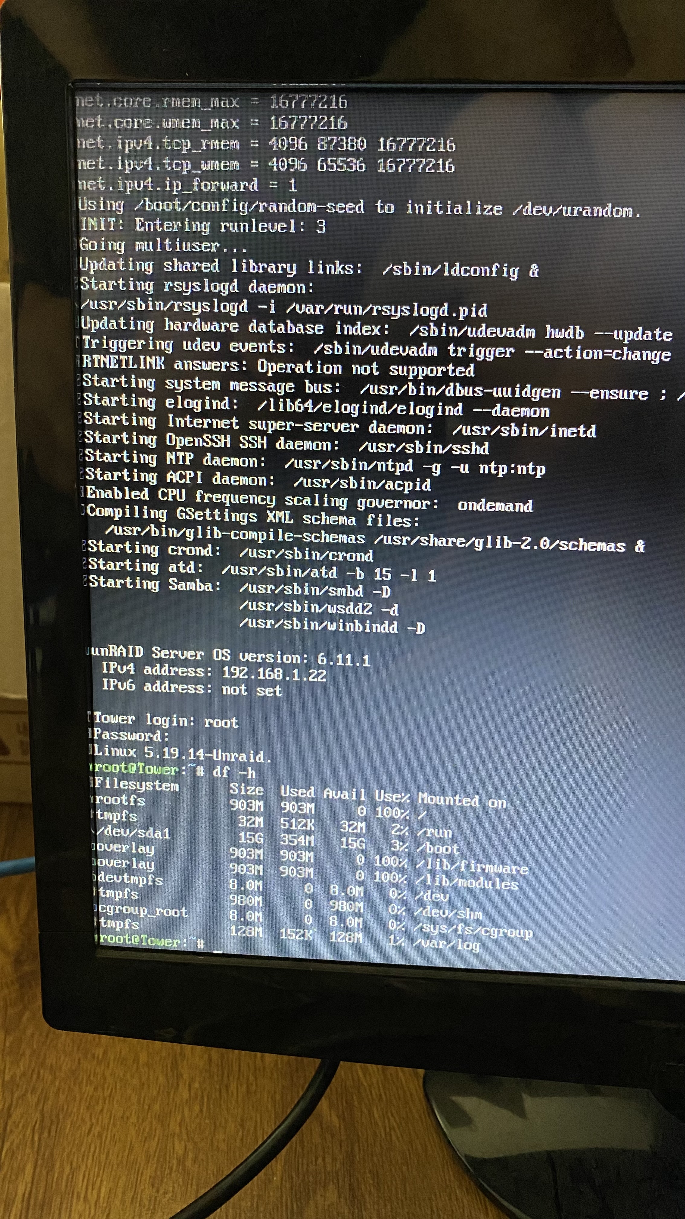

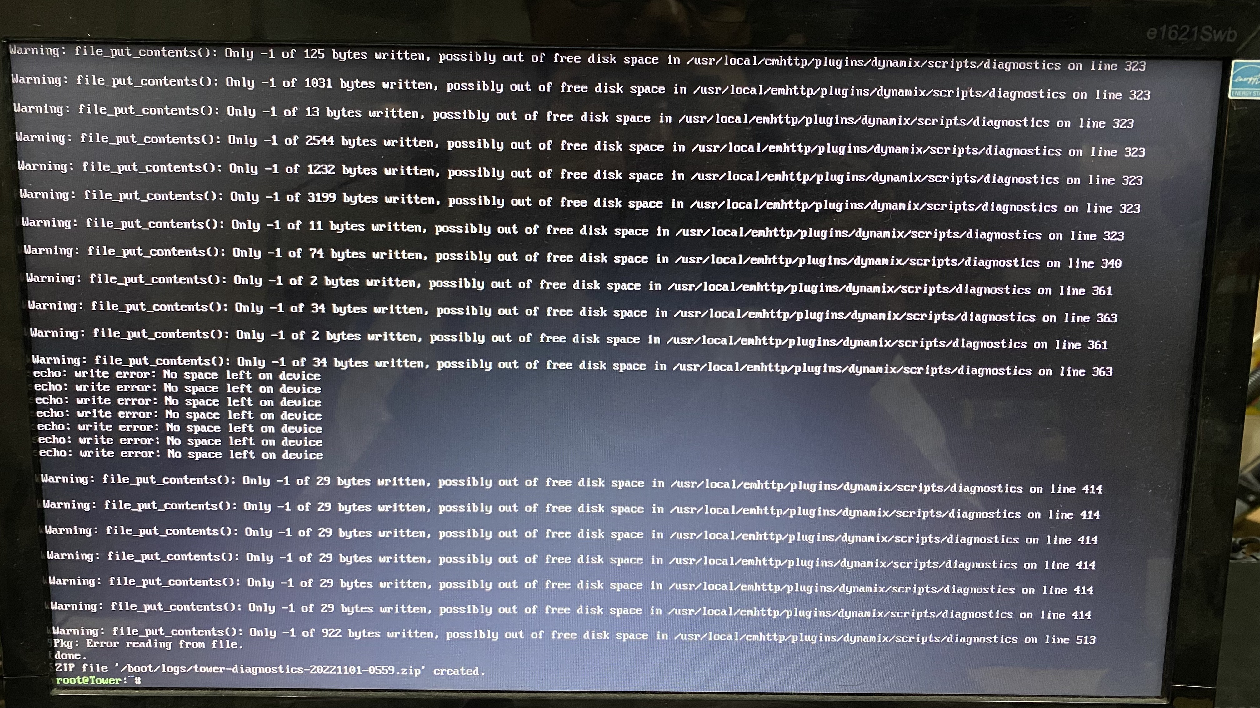

Hi. I did plug a keyboard and monitor onto it, and I can login as root. Though I don't know how to generate diagnostics from the console. I later recreated Unraid on a new USB, doing new config, doing everything all over again (lucky there isn't any content of importance, and I also want to redo it). This seemingly has been consistent already, at least for now. I then have another system, also Unraid, also experiencing the same problem, can login when keyboard and monitor is plugged, but not accessible via web gui. Before I updated the My Server plugin, it seems to work fine. Could the old My Server plugin, when upgraded to the latest, possibly cause this problem of not being accessible in web gui? To test my theory, what can I remove from my USB to remove the recently upgraded My Servers plugin?- Access to web gui on and off. Can ping w/out problems. Putty sometimes work
Hello. Anyone? I've since replace my USB to a new one, replaced the license. I've deleted all the contents of config except for the license key. Up to now, access to web gui is intermittent. But right now, it's totally inaccessible. I've connected a monitor and keyboard to it. I can see that it's assigned an IP address. But heading to that IP address via browser doesn't give me the web gui. Pinging still works. Running out of ideas of how to troubleshoot. - Access to web gui on and off. Can ping w/out problems. Putty sometimes work
