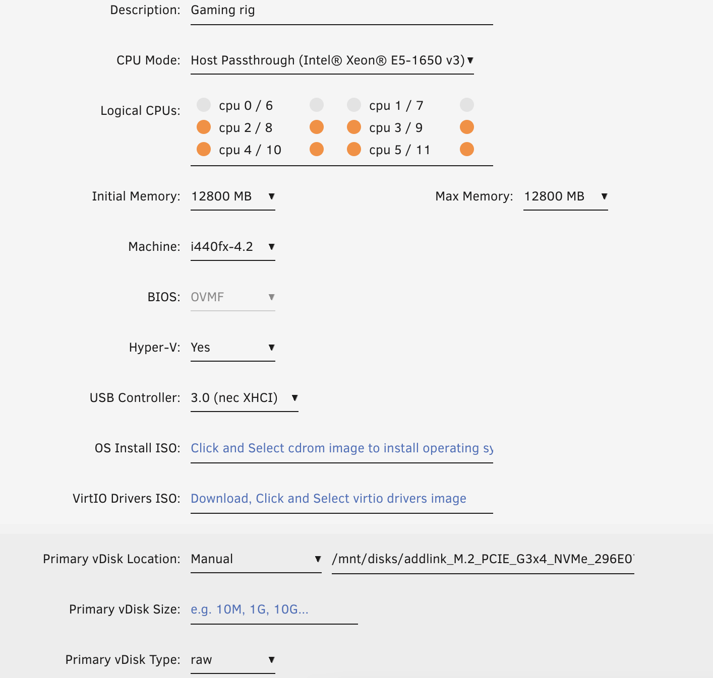

My current build is Xeon E5-1650 v3, on Supermicro X10SRM-TF. It's somewhat perfect. I have a 1050Ti passed through for use on gaming vm. With GPUs so expensive, I don't want to buy a video card right now. I toyed with the idea of having Emby server on a single board computer. Having Emby server on SBC accessing shows on my NAS. But I don't know which SBC is capable of having hardware transcode enabled. Can anyone suggest?

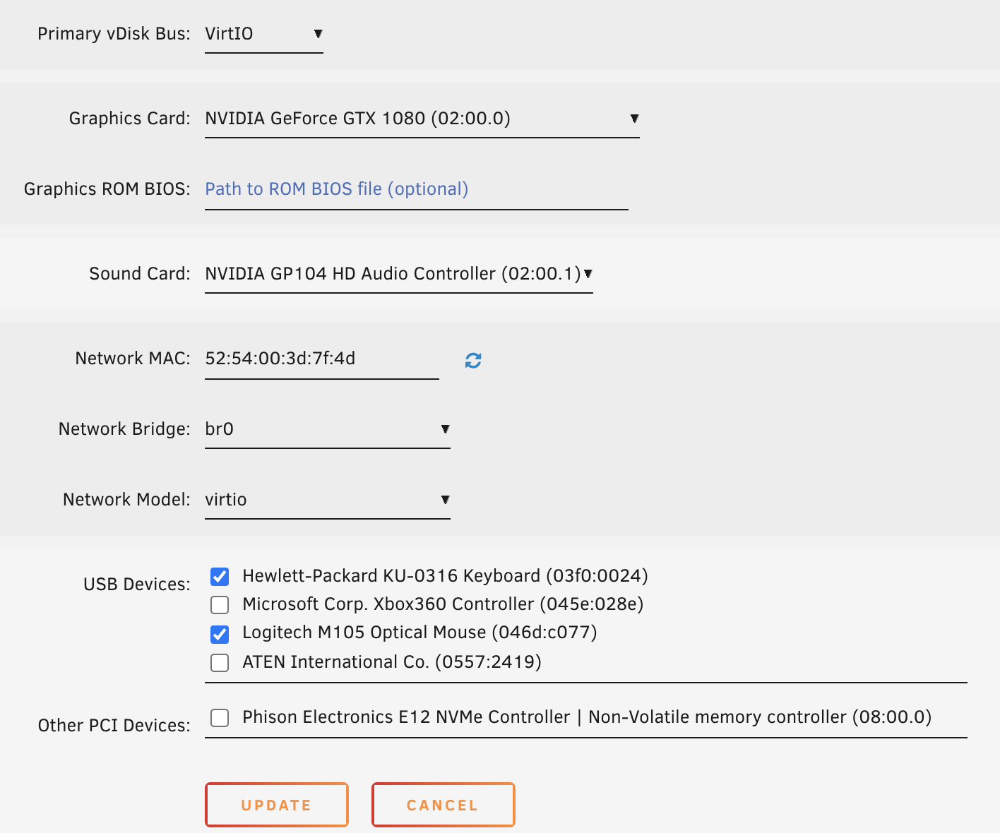

My purpose is to passthrough my NVME SSD. I believe I should be binding the Phison controller (says NVME). After binding it, restarting... When I go to the VM, I can see the controller in Other PCI devices, with an unchecked box (what should I do here). I don't know how to point my Primary vDisk to the said SSD when it's no longer presented on the choices.

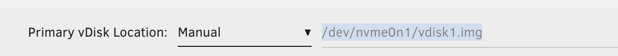

Before binding Phison controller (NVME SSD) to VFIO, I first unmounted my NVME SSD from Unassigned devices. After binding, and reboot, Unassigned devices doesn't "see" NVME SSD. Neither does making my Primary vDisk location /dev/nvme0n1 work, as it doesn't "see" /dev/... Any advise?

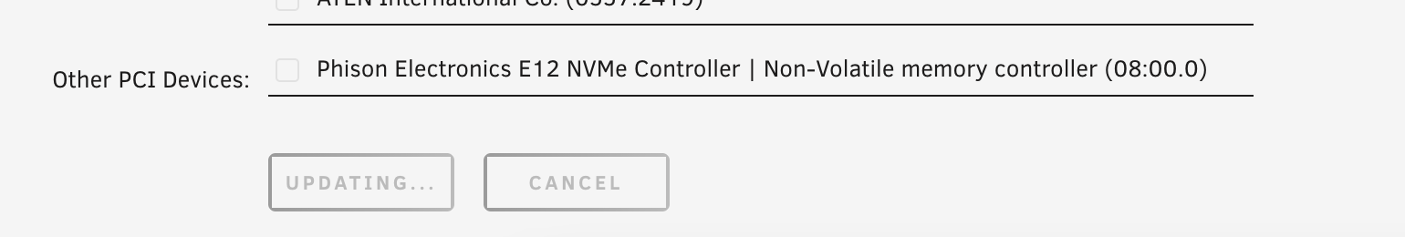

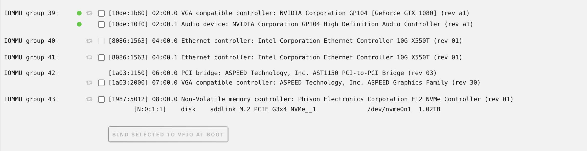

@domrockt, Sorry missed your reply earlier. Not yet familiar how stubbing goes. I see the following on my system devices page- Do I just tick on IOMMU group 43, and click on "BIND SELECTED TO VFIO AT BOOT?" Will this achieve my goal to pass through NVME to VM directly? Anything I should be checking in syslinux.cfg? What exactly does stubbing do? EDIT: After doing above, I can now see in my VM page: shall I tick this? Furthermore, changing Primary Vdisk location to /dev/nvme0n1/vdisk1.img and saving leaves it in updating, but nothing is being saved. Lastly, the nvme disk is no longer in my unassigned disks, and it says it's missing.
