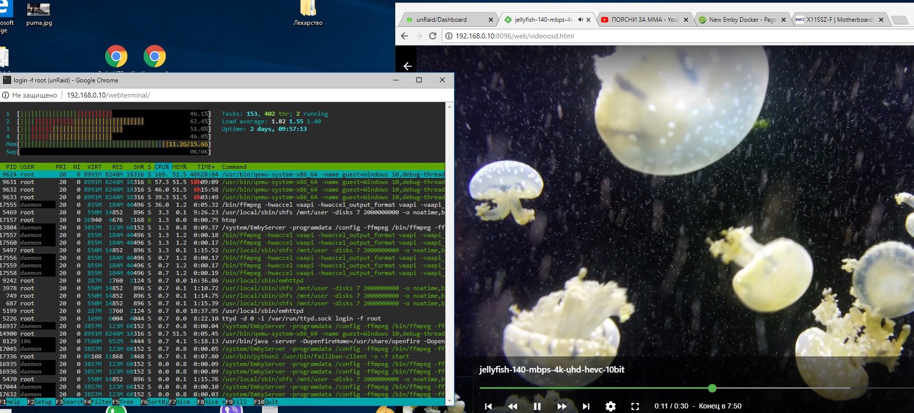

Is Xeon Silver 4108 capable of 10 bit hevc transcoding? H.265
vanes replied to jang430's topic in Motherboards and CPUs
@jang430 you dont need new hardware you cpu has Intel® HD Graphics P630 https://ark.intel.com/products/97476/Intel-Xeon-Processor-E3-1225-v6-8M-Cache-3-30-GHz- it support 10-bit H.265 4K https://www.intel.ru/content/www/ru/ru/architecture-and-technology/hd-graphics/hd-graphics-performance-guide.html u need just to set-up unraid and plex/emby to use it Xeon silver 4108 is ~30% faster and have no iGpu. Did u set up iGpu transcoding or you dont use HD Graphics P630 at all? -

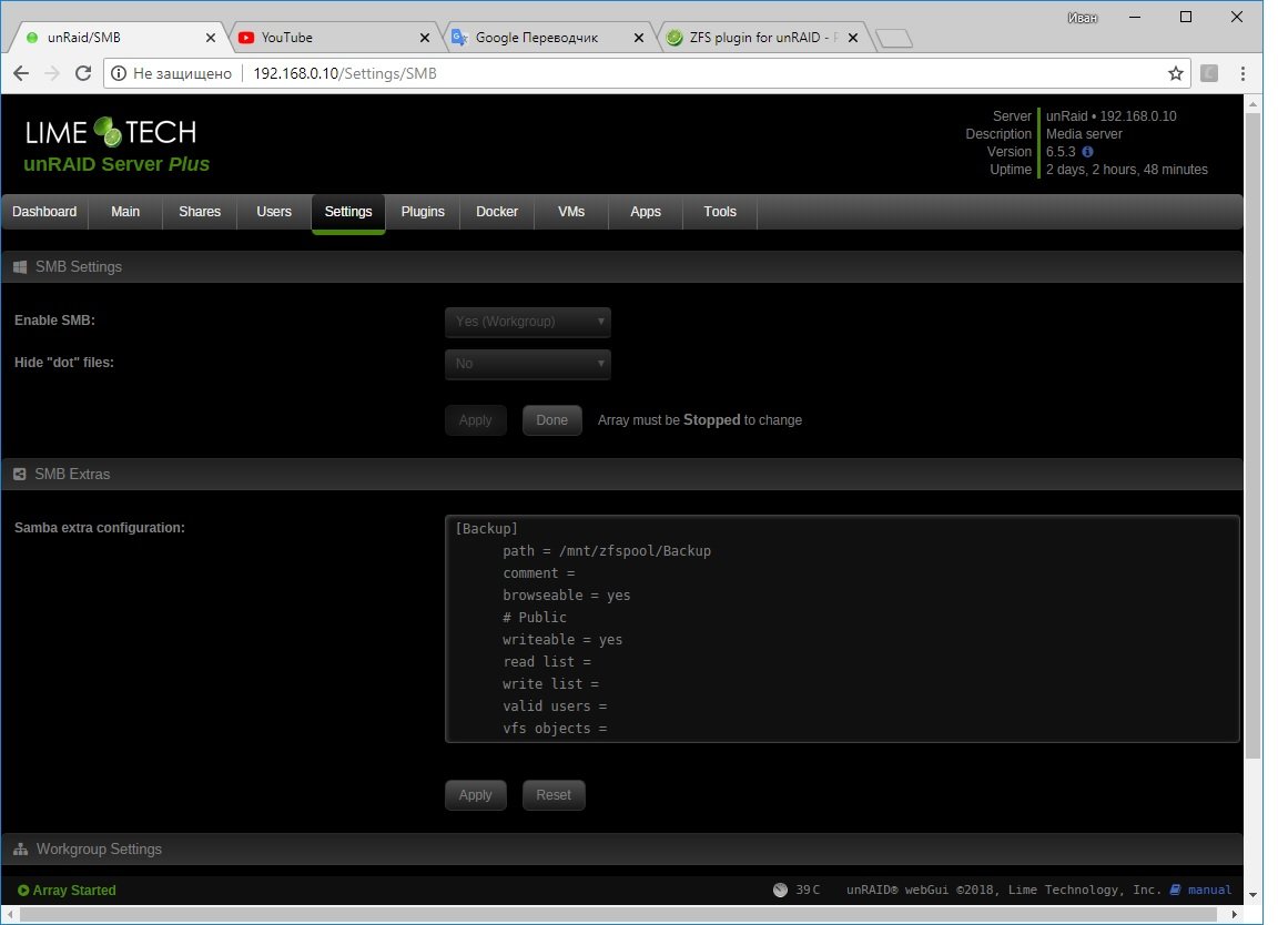

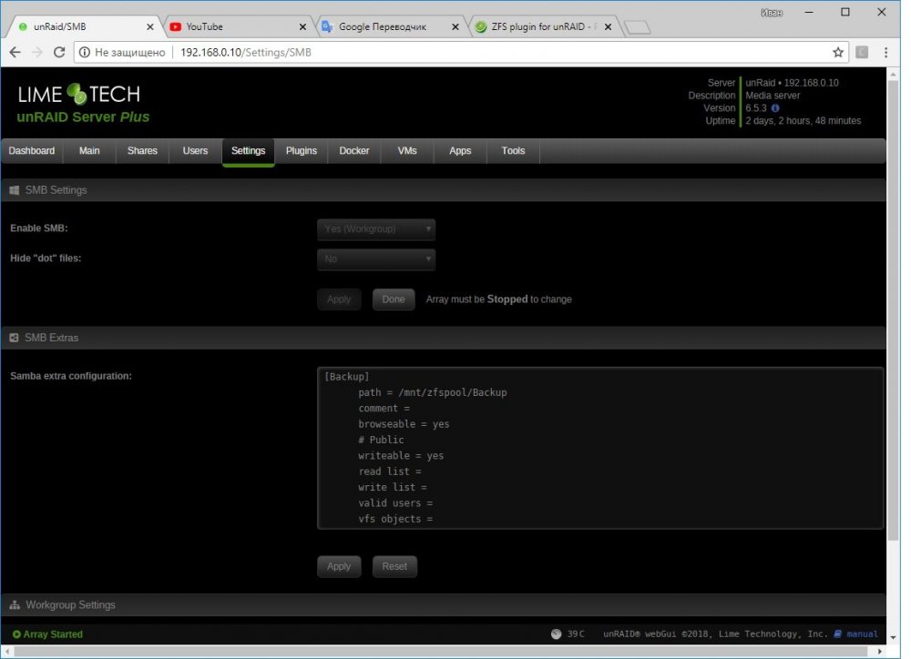

I am not zfs-guru, my first zfs pool was created some weeks ago. I use 2 usb hdd drives in mirror (raid1) for zfs-backup-pool, rsync by user-scripts copy important data there once a week. I limited ARC cache of 2Gb memory using user-scripts. Totally my system have 8Gb of RAM.
you can try use zfs plugin to create zfs pool for backups, then share it using smb-extra config.

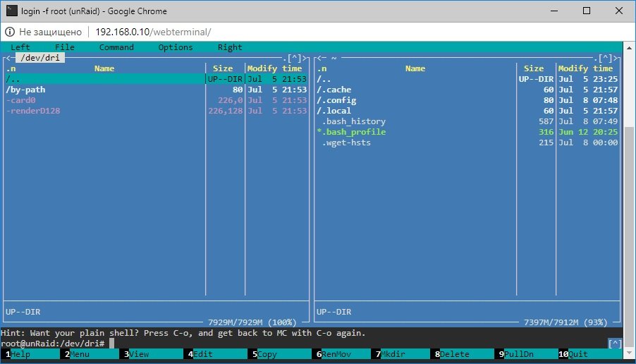

I recently bought AsRock e3c236d2i and I can confirm that it allows to use intel video core, but only for video encoding/decoding, not for display....
take a look at this. double check all bios settings, nomodeset , go file, etc
Yes my go file is: #!/bin/bash #enable module for iGPU and perms for the render device modprobe i915 chmod -R 777 /dev/dri # Start the Management Utility /usr/local/sbin/emhttp & container Extra-Parameters:
