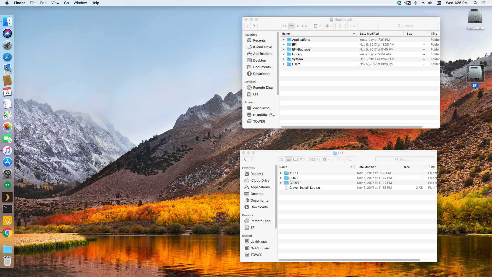

This is the video for virt manager stuff. Its not easy but it makes adding new hardware a lot easier. As for the migration for some reason in my case whenever i tried installing clover to the main drive in MacOS it would install CLOVER to the root of the main drive and not the EFI partiton. Don't know if its a issue with the version of clover i was using or it being really a vdisk it wouldn't do it. I would mount the EFI partition of the main disk and all the was there was a APPLE folder. If you look at the pics CLOVER actually created a EFI folder on the Hard drive. The wrong spot. So i just mount the EFI partition and straight copied the contents of the EFI folder on the main disk to the EFI folder in the EFI partition.

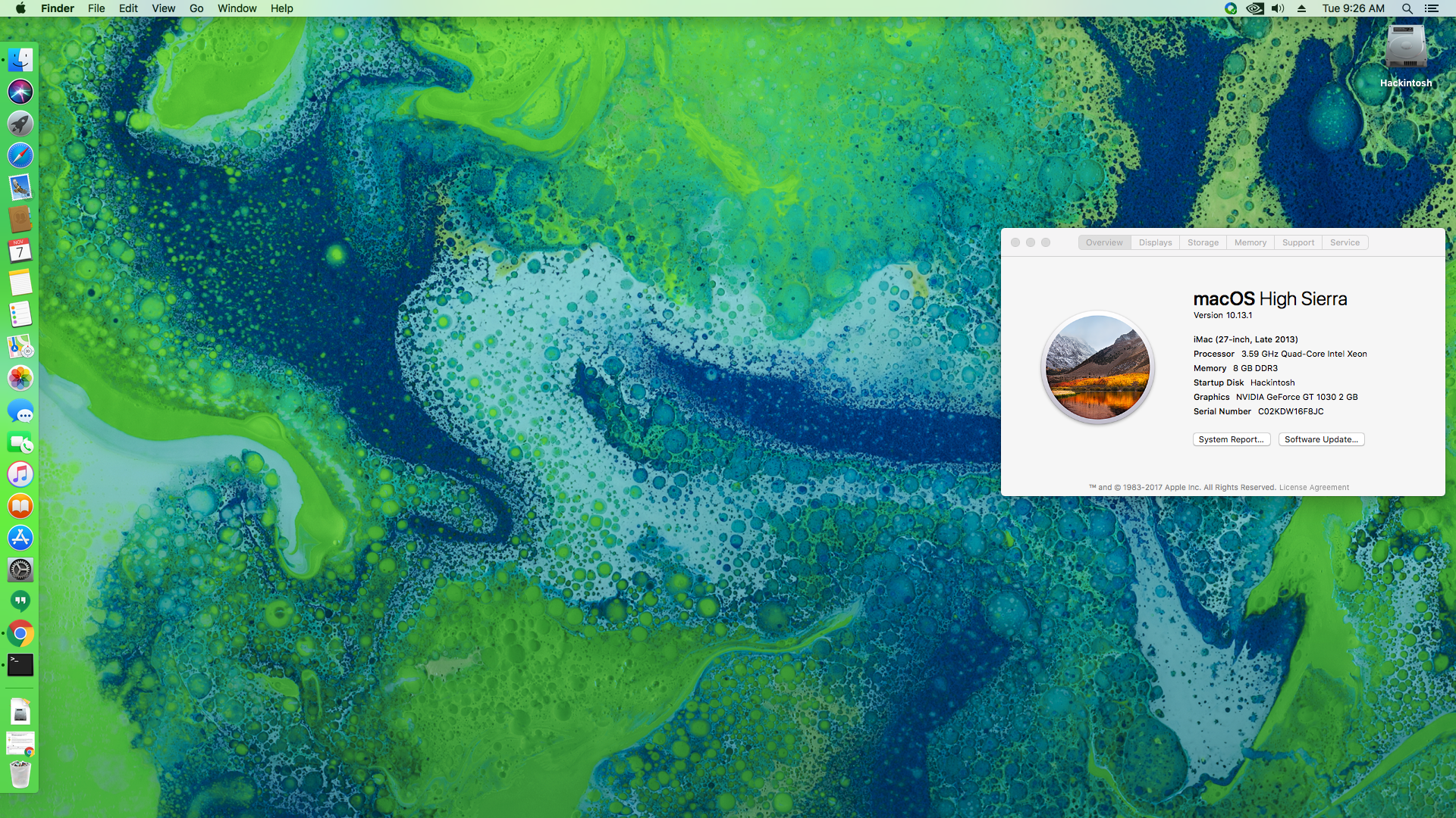

Big Thanks gridrunner, I got a High Sierra VM working with a GT 1030 passed thru, a bluetooth 4.0 dongle for bluetooth audio and a usb Roccat Juke for my headphones. Im using synergy so i don't need a mouse or keyboard plus this VM is mostly used as a HTPC. I added most of the devices using virt manager in a ubuntu vm. Im running a Ryzen r5 1600x and i gave the vm 4 cores 8 threads. Its running really well. Nvidia web drivers installed without issue and its using the apfs file system. Thanks for all the guides.
