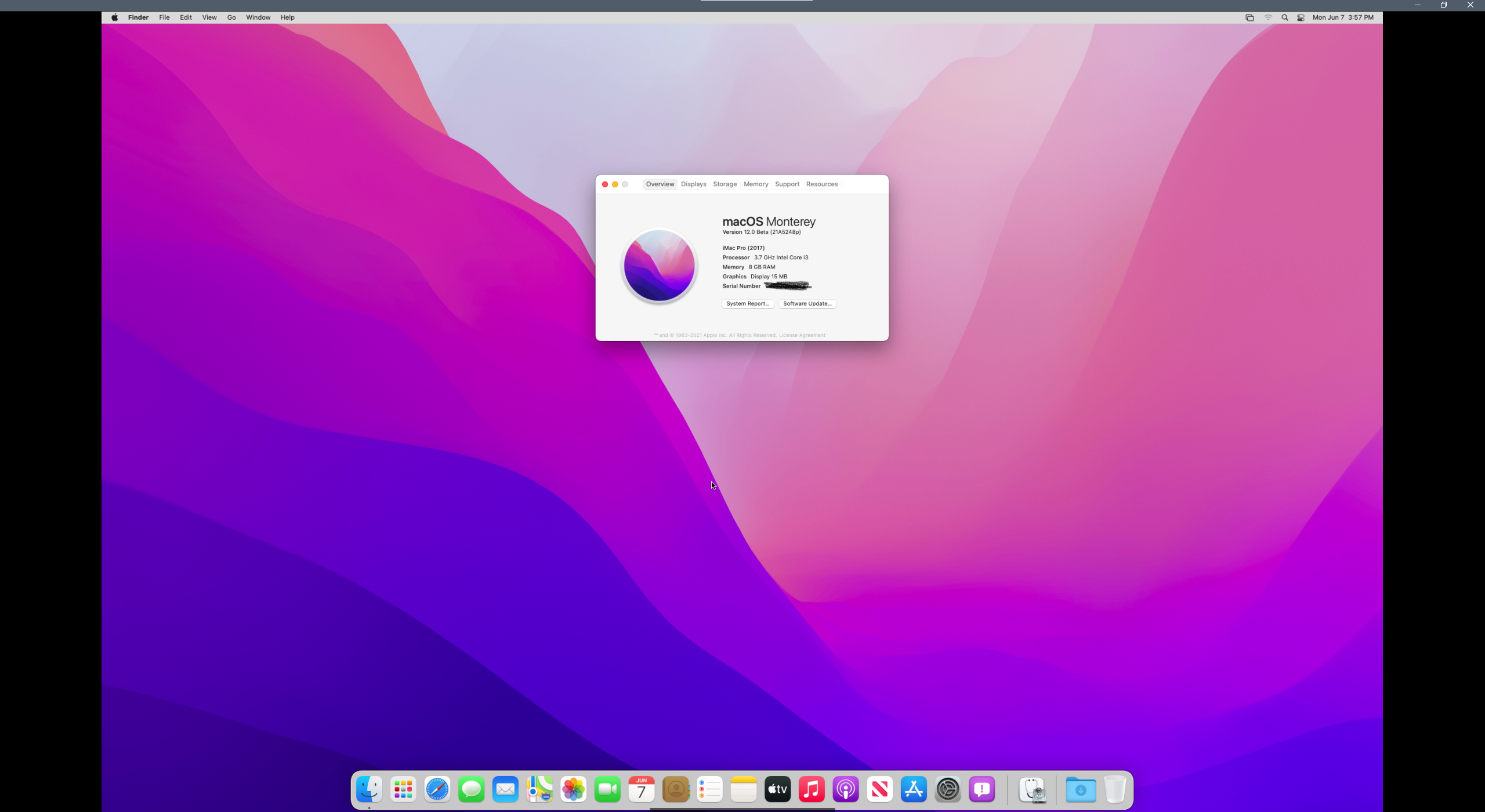

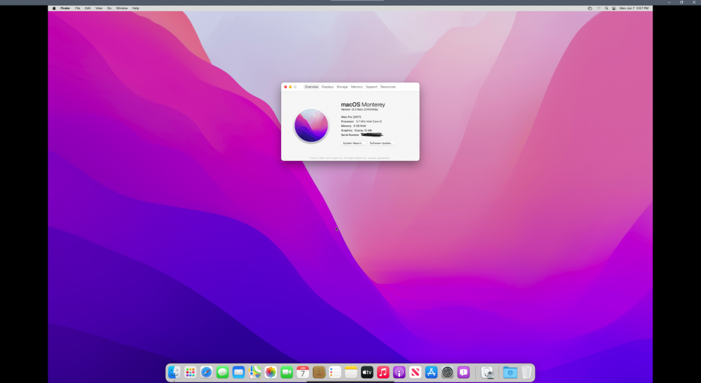

I have -lilubetaall in the boot args thats the only thing i added there. The OC im using is 0.6.3 version for the VM. My laptop running Monterey is on 0.6.9 with pretty much the same boot args and all my kext were update as of the yesterday. I will say i have a bug where it boot loops on VNC for some reason. Passing thru a gpu maybe more stable.

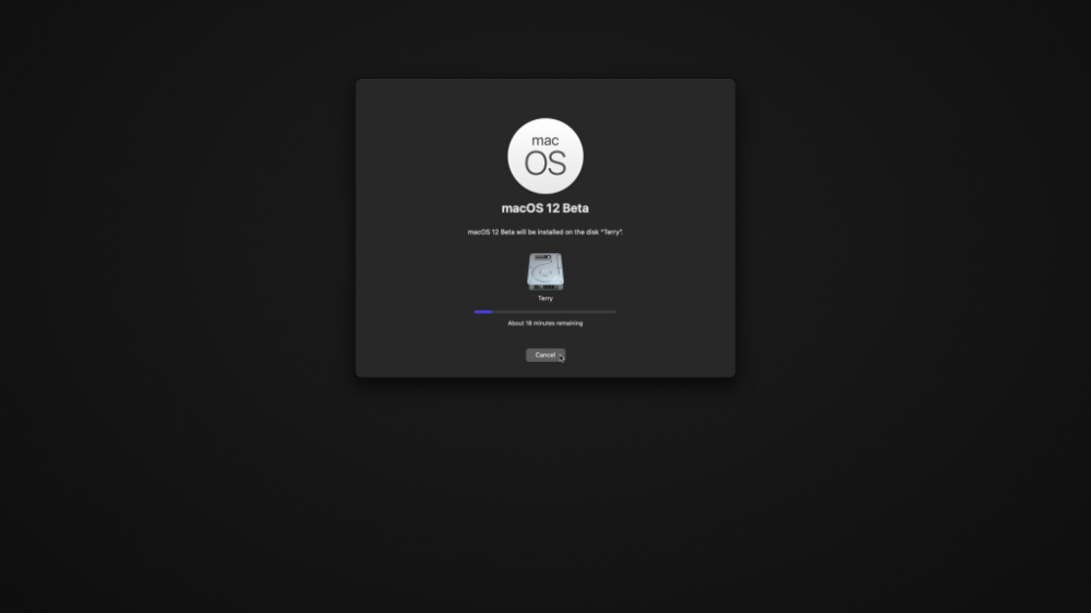

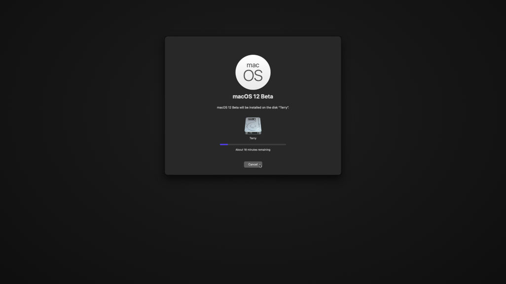

Simple install with any recently updated version of opencore. I hear bluetooth breaks boot on bare metal so i would avoid that. Im using virtio for the network and the disk type and it boots just fine. Now to see what does not work.
