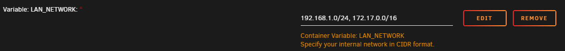

  13. I have the exact same problem and I have followed the FAQ and input my CIDR correctly but it still does not work. There's something like 50+ other complaints over the years, on the forum here, Github and Reddit about the exact same issue due to the aggressive VPN/firewall blocking everything locally. So I have really checked and read through everything before coming here to request help. Container IP and Port Mappings: Custom Docker network for all my publicly accessible apps: I have the WebUI port set to 8128: LAN network variable is correct according to the FAQ: Unraid is running on: 192.168.1.50 and qbittorrentvpn has the same IP address, and should be accessible at: 192.168.1.50:8128 But I get the usual: Using cloudflare I can of course access qbittorrent via the internet, however I have this behind zero trust cloudflare access. So I have to auth into that first and then into qbittorrent. I still need local network access so I can use Radarr/Sonarr/Bazarr and the Flood WebUI. @binhex I am really sorry to ping you mate, but can you explain why this doesn't work still, even after putting in the right values?
