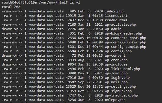

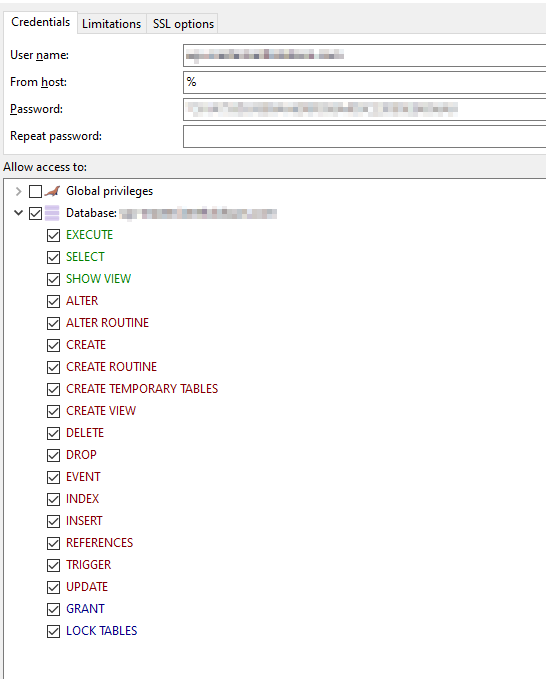

  6. It was in the container I looked for the missing log. Anyway, tried the export/import and that didn't change anything. Since the only thing that didn't work after the migration was this plugin I removed it from my 13 sites for the time being ๐Ÿ™‚ Trying to understand the permission issue.... The database has full permissions, the files/folders has either www-data or root... I'll do some more thinking....

  8. I tried setting this in wp-config.php and wp-config-docker.php: define( 'WP_DEBUG', !!getenv_docker('WORDPRESS_DEBUG', 'true') ); define( 'WP_DEBUG_LOG', '/var/www/html/wp-errors.log' ); But no debug log is created in the dockers /var/www/html folder Did some more testing, I can change and save other information in the user profile but the TOTP will not save.. Plugin folder (and files) has correct user/group
  9. No, I haven't. Shouldnt be files permission And the database user has all rights fot it's database Is there other permission to consider?
