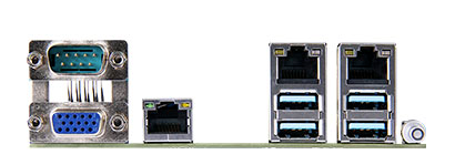

  2. The E3C246D4U has a dedicated LAN port in addition to the two Intel ports. I've also added a 10G card.

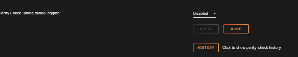

  10. I have the following debug messages every five minutes in my log: I did verify that I have logging disabled. This started after the most recent update - 2020.10.23

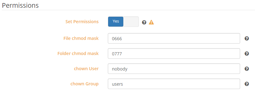

  11. Sorry, should have linked to the second response and not the thread. I was also having permission issues until I enabled the Set Permissions option. I did change the chown User to 99, and chown Group to 100 but it appears either works.
  12. @unRAIDuser7 @TexasUnraid have you tried the "Set Permissions" option in Sonarr, as explained at:
