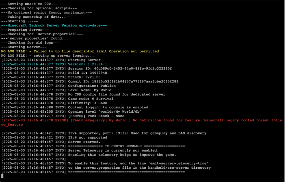

Hi @ich777 , I've been running your MinecraftBedrockEdition server for years without issues but recently it seems to be stuck on version 1.21.84.1 and I can't get it to upgrade to the latest version which is 1.21.95.1 so none of my iPad clients can connect to it. I've tried restarting the server but it doesn’t seem to dedicate that a server update is available?

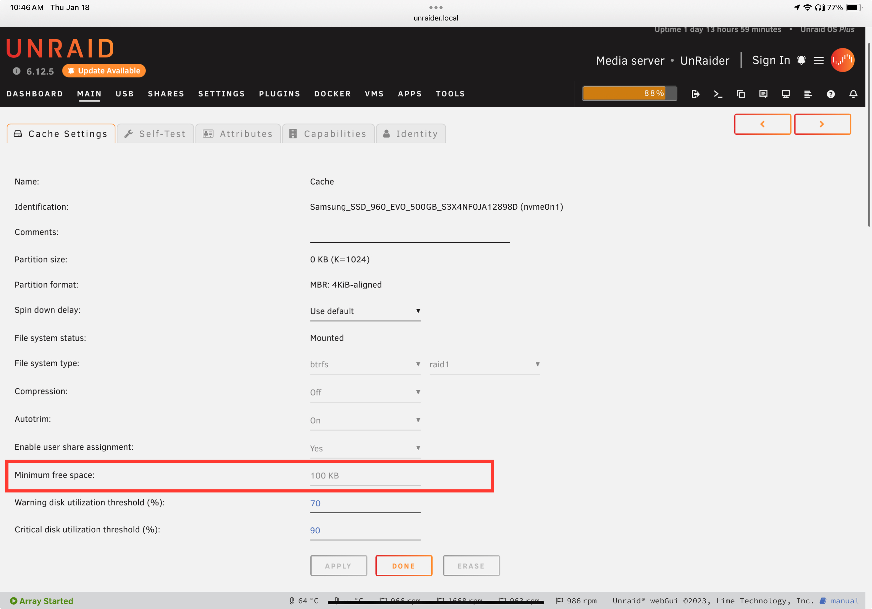

Thx @itimpi! Not sure if I'm still misunderstanding how this works but stopping the array and changing my Minimum Free Space to 4G instead of the 100KB is was seemed to do the trick. I felt as if the original setting should've worked but perhaps something else was going on 🤷♂️.

Thx @itimpi! I checked this setting for my cache and it's set at 100KB and I currently have 69GB free?

The Fix Common Problems plugin has been notifying me of "Out of memory" errors and I've also noticed that my logs are filled with "UnRaider shfs: cache disk full" errors. Not sure what the issue is and hoping someone can help. unraider-diagnostics-20240910-2214.zip

I misspoke somewhat, the webui wouldn’t load but my dockers and VMs were still accessible. I had a hard time finding this setting initially, but I believe it’s the one in the screenshot below , which currently looks to have a minimum free setting of 100 kB vs 100 GB - is the wrong setting? Additionally, I’m not sure how to change this value, perhaps I need to first stop the array? No reason really – reading through the release notes iIt felt like this was an optional step but I’ll go back and reread it 😅.

Hi, I'm getting this error filling up my logs which caused my server to stop responding earlier today requiring a reboot. After doing some search it seems like this error is usually caused by one of the shares exceeding it's minimum free space however looking through my shares I'm not seeing one like this? unraider-diagnostics-20240116-2323.zip
