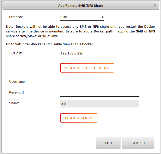

Looks like I was wrong. When it is a windows drive share I have not been able to get it to authenticate without a username our password, but if it is a folder share it works great. I have attached the files for the folder share. There is no point attaching the files for the drive share as even in my Windows machines it is asking for credentials samba_mount.cfg
I was entering just the ip address and the share in the share section. I tried the everyone and guest accounts with no password but that did not work as it complained about a missing password.
Looks like it works other than when it is a drive share using the Advanced Share. When it is an advanced share it complains it can't be found in fstab, below is the command it ran and the error. I have tried running a few test commands to get a working one but no luck yet, but that is mostly me being a linux noob. I will continue testing this weekend and let you know. If you need or want anymore testing for Windows let me know and I will do my best to help out. mount -t cifs -o '//192.168.0.226/f' '/mnt/disks/192.168.0.226_f' mount: /mnt/disks/192.168.0.226_f: can't find in /etc/fstab.

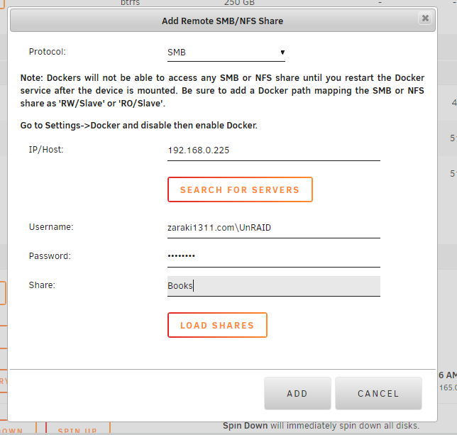

Here is an example. There are 2 ways to enter the domain that are standard. Domain/User or user@domain. A possible solution would be to add an optional domain field below the user.
So After a little playing I have sort of got this to work. If I copy the mount command and give it the domain parameter and run it in the terminal it works fine and shows in UD like it was setup with UD, but if I reboot I have to remount manually. Below is an example of what I ran. Is there a chance that support for domain users will be added? mount -t cifs -o rw,nounix,iocharset=utf8,_netdev,file_mode=0777,dir_mode=0777,,vers=3.0,username=UnRAID,domain=zaraki1311.com,password=******* '//192.168.0.225/Books' '/mnt/disks/192.168.0.225_Books'
Hello, I have been using this plugin for a few months now without much issue, but today I made a few changes in my network that seem to have broken a few things. My current setup is my my unraid server is basically just to run VMs and dockers. My main storage is a QNAP server. I have been using Unassigned Devices to map my network shares to my dockers. The change I made today was to make my QNAP an domain controller. This change makes it so a domain account is required to access a share. I have configured all of that, but it appears that I can't connect to the shares with Unassigned Devices now. I am using SMB to connect and adding the domain to the front of the user. All my Windows machines seem to be working fine connecting. below is the log I get from unraid. Any help would be greatly appreciated. Mar 13 19:05:40 ArlongPark unassigned.devices: Mount SMB share '//192.168.0.225/Books' using SMB3 protocol. Mar 13 19:05:40 ArlongPark kernel: Status code returned 0xc000006d STATUS_LOGON_FAILURE Mar 13 19:05:40 ArlongPark kernel: CIFS VFS: Send error in SessSetup = -13 Mar 13 19:05:40 ArlongPark kernel: CIFS VFS: cifs_mount failed w/return code = -13 Mar 13 19:05:40 ArlongPark unassigned.devices: Mount SMB/NFS command: mount -t cifs -o rw,nounix,iocharset=utf8,_netdev,file_mode=0777,dir_mode=0777,,vers=3.0,username=zaraki1311.com\UnRAID,password=******* '//192.168.0.225/Books' '/mnt/disks/192.168.0.225_Books' Mar 13 19:05:40 ArlongPark unassigned.devices: Mount of '//192.168.0.225/Books' failed. Error message: mount error(13): Permission denied Refer to the mount.cifs(8) manual page (e.g. man mount.cifs)
