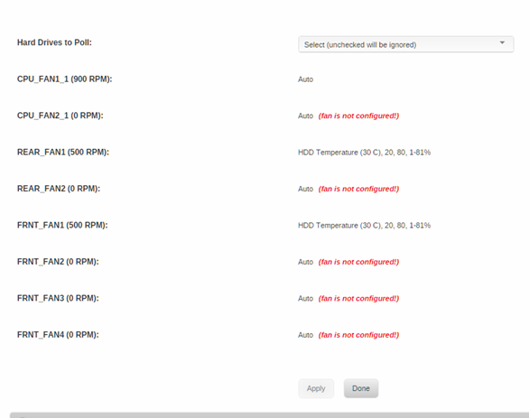

  4. That made a big difference. Now showing more fans and they now have slowed down from full blast.

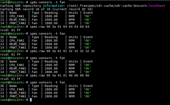

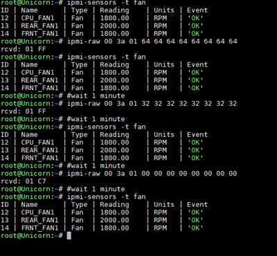

  5. Hi; My bad. My signature has my other MB (SuperMicro) used for my Edge Modem. This MB is an ASRock E3C226D2I. Here are the results from your last. I waited at least a minute between the config command and the fan status command. I noticed a slight difference between your last commands and this time with the response. Note the last config command has a "01 C7" response rather than the "01 FF" response of the previous config commands. I could not find within the IPMI GUI interface a way to adjust the fan speeds. Here is the IPMI Version:

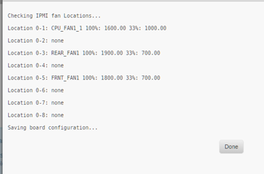

  7. Yes, that is correct. The board only has a single socket. I have a single Intel i3 CPU in it.
  8. While troubleshooting I note a possible error in the script used to run ipmifan. Please note that I: 1) Stopped the Fan Control 2) Deleted the .config files under /boot/config/plugins/ipmi/. 3) Re-ran the Fan Configuration. It still does not locate any fans. See my original message: No locations found for fans. 4) Going into terminal, I ran the following: root@unicorn:/user/sbin#ipmifan --auto sh: -c: line 0: syntax error near unexpected token `;' sh: -c: line 0: `ipmi-raw 00 3a 01 00 00 00 00 00 00 00 00 -h 'xxx.xxx.xx.xx.xxx -u 'xxxx' -p 'xxxx' --session-timeout=5000 --retransmission-timeout=1000 2>&1 >/dev/null &; ' Note: Running the said command "ipmi-raw 00 3a 01 00 00 00 00 00 00 00 00 -h 'xxx.xxx.xx.xx -u 'xxxx' -p 'xxxx' --session-timeout=5000 --retransmission-timeout=1000 2>&1 >/dev/null &" works, but the fans are still running at full speed: How do I fix this error which may be the reason why the plugin does not control the fans?

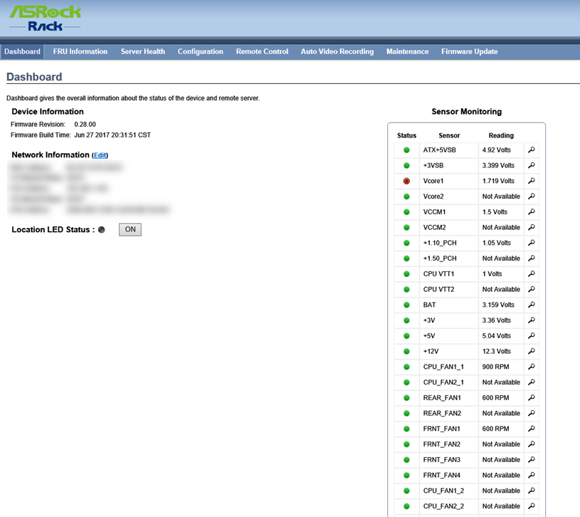

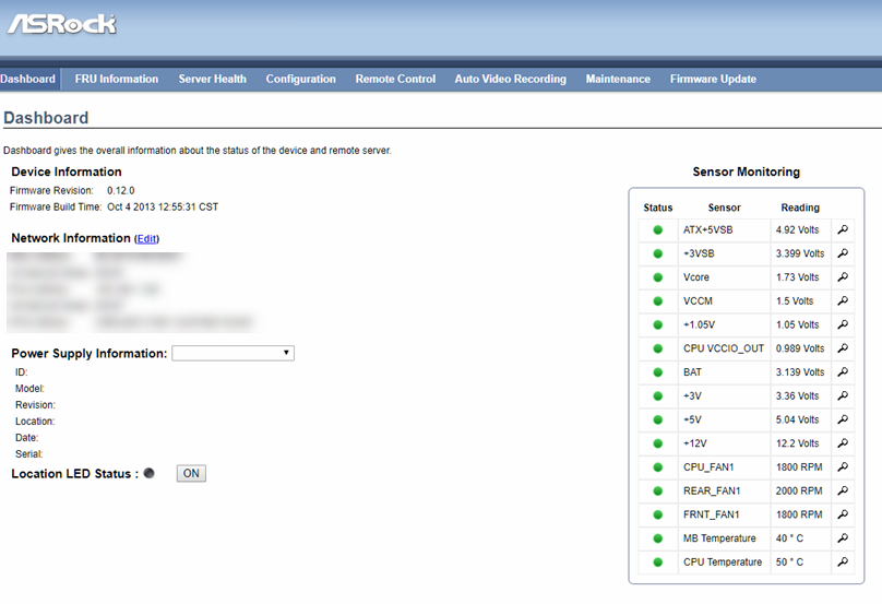

  10. I have installed three Noctua fans all with 4-pin PWM. NF-A14, NF-F12, and NH-L9i. I cannot seem to run ipmi when logged in. root@Unicorn:/# ipmi -bash: ipmi: command not found root@Unicorn:/# Where is it typically installed?
