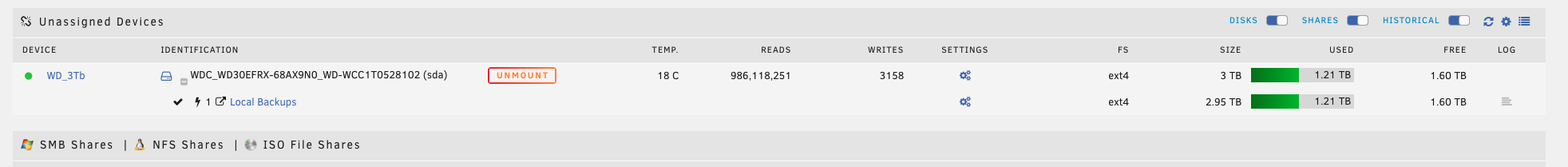

I just checked these and enabled enhanced MacOS support. This now allows me to access the Backups directory. The lost+found folder i'm not too worried about. It still has the no entry sign on it and won't let me in.
But this is precisely why I posted asking for help. To find out why I cannot access it like a regular share.
It's exported as a Share so surely I should be able to access it just like any other share?
yes I understand that, but why can’t I access it? I have several sub folders in the Backup one but can’t access them. What’s the no entry sign icon for? surely I should be able to access them via Finder?
Hi, I have one 3Tb disk in Unassigned Devices. It has one partition that I have labelled "Local Backups". I have set it to be shared. When I connect to it via Finder, the folders within show up as in the screenshot. Why is this? The disk is also shown in the second screenshot: Thanks in advance, Neil
