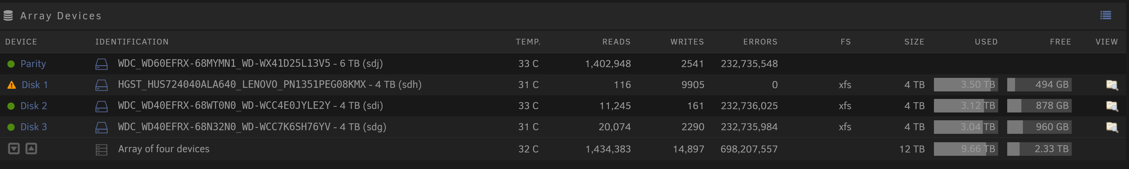

  3. Hi community I have a kind of potentially massive issue..... I found out yesterday that one of my disks had been disabled due to errors, or something like that. I then (half an hour ago) replaced the disk with another one I had lying around. I made a clean shutdown, and replaced the disk while unpowered, booted up again, and assigned the disk (Disk 1) with the new disk and parity started building. I then after 10 minutes get a notification that the disks is experiencing massive error counts (See screenshot diskerrors.png) The disk 1 seems to be rebuilding, but what do I do with all these errors? Pasted the diagnostics as well. Hope someone out there will take a little time to help out I'm no expert, but that error count seems unhealthy..... jinx-diagnostics-20220401-1617.zip

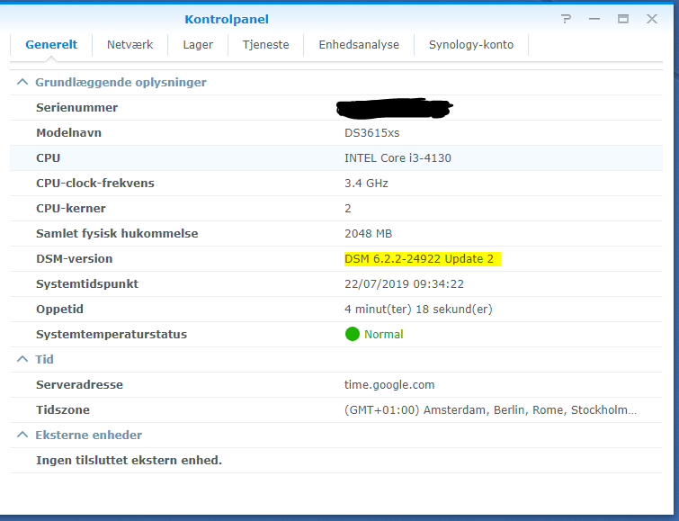

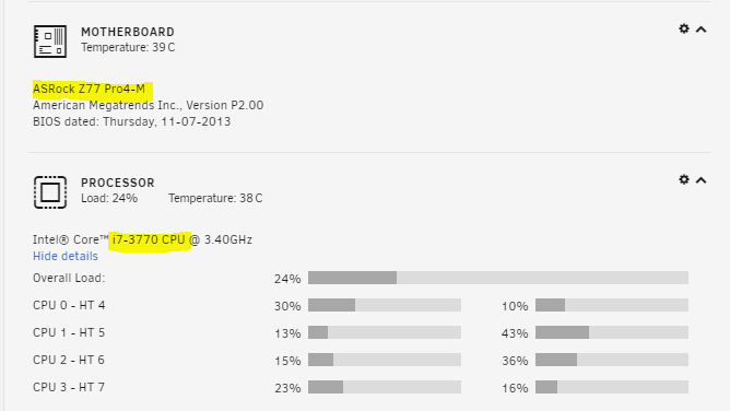

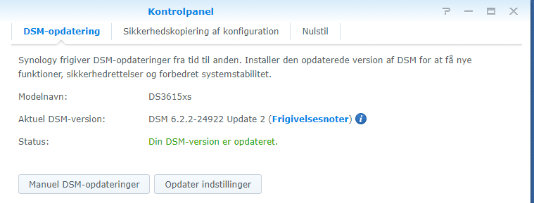

  7. Just did the same as above on a i7-3770 on a ASRock Z77 Pro4-M today, and following the same procedure I got the same result. Works flawlessly. Thx again for the pointer. I don't know why it says it's an i3-4130, but it works, and that's what matters
  8. Did the above and can confirm that it works. For me at least. I too am rocking af supermicro. My board is a X9DAL though with dual E5-2418L Xeons I've been trying before without luck. Not with the newest version though. But it is the first time i've tried to set the NIC as "e1000e" and not just "e1000". If that made the differance or not, I don't know. But if works now for sure. Thanks for the pointer
