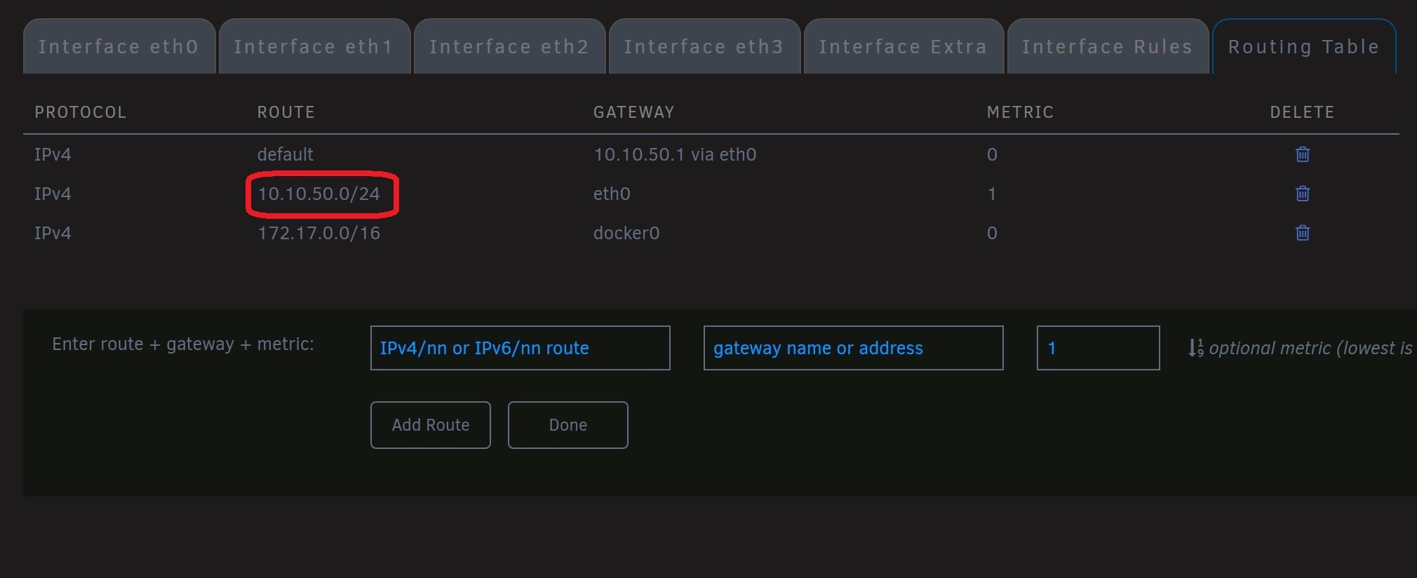

  1. I recently updated my network from a /24 subnet mask to a /23. I just needed/wanted more address options. I went to log into a SMB share on my windows computer and noticed that my unraid server wasn't showing up in my windows "Network", but I could type the address in and it was accessible. In my UnRaid Network Settings it shows the route still being 10.10.50.0/24. I've deleted it and added /23 but when I reboot it goes back to /24. I cant find an option to manually input the subnet mask...How do I update it to the rest of the network with a /23?

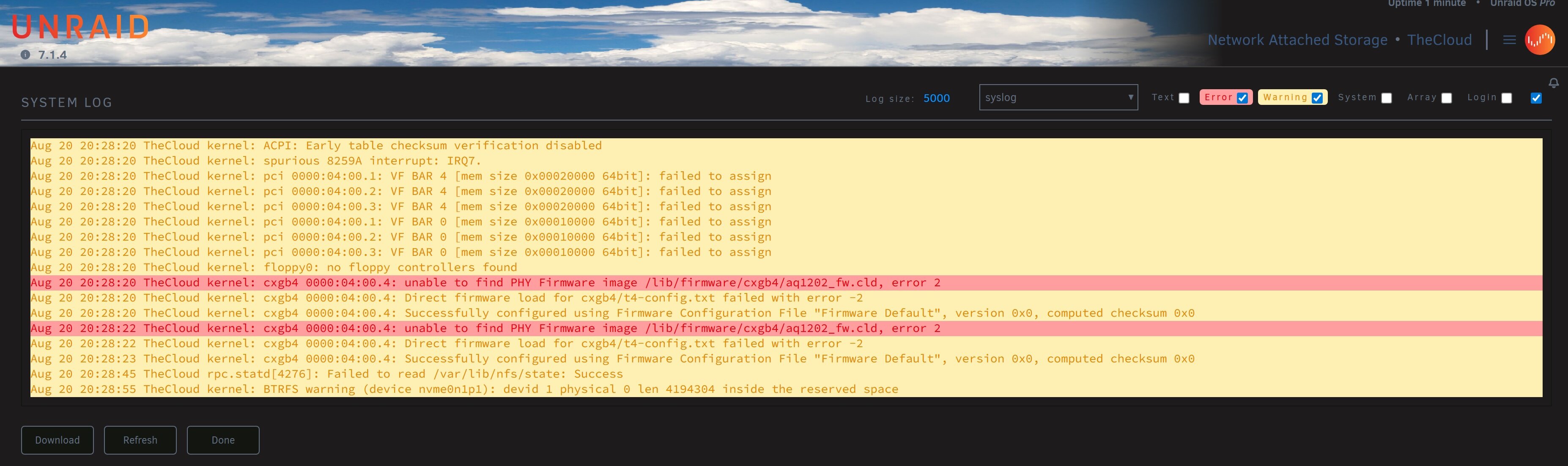

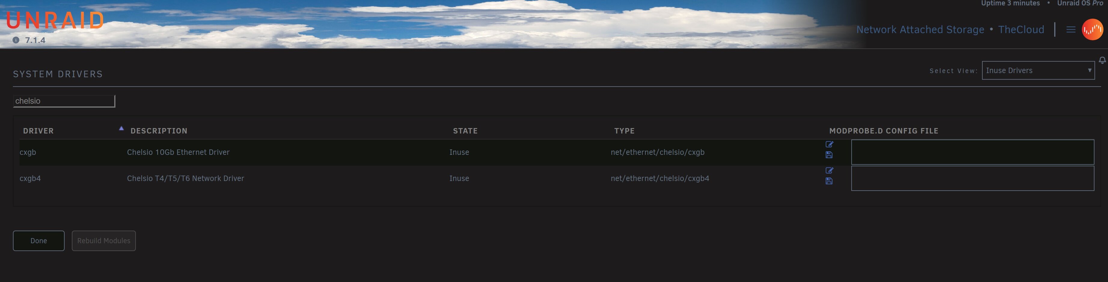

  5. I'm not sure what I did or what I changed, but something is messed up. As the titles says, my access to the GUI and my SMB shares goes dead after a few minutes. I reboot and it comes back...for a few minutes. I was able to look at the logs and here's what I found of note... Google says the red error "indicates a missing or improperly installed firmware file required by the cxgb4 driver, which likely corresponds to a Chelsio network adapter using the AQ1202 PHY." Here's what I have for Chelsio Network Drivers... Could a driver update fix the issue? If so, how does one update the driver? Maybe it's something else? I've downgraded to 7.1.3 then upgraded back up to 7.1.4 and it did the same thing. Any ideas on how to fix this?
