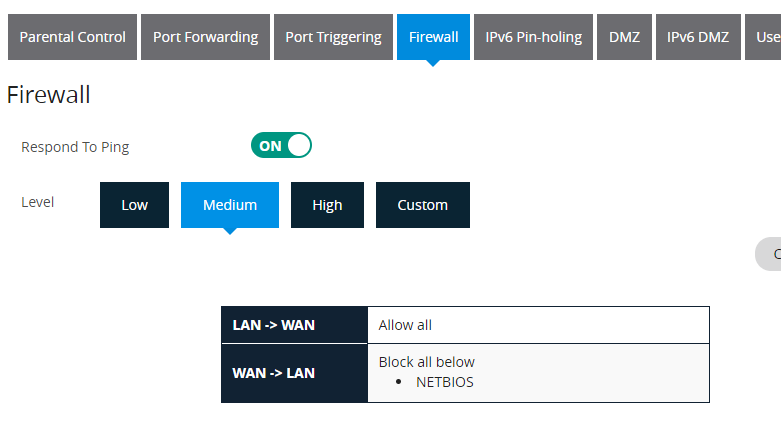

Do you guys think this would be my problem? See screenshot. Also, i cant change the dns on my current router from my ISP. I think this could be a problem.

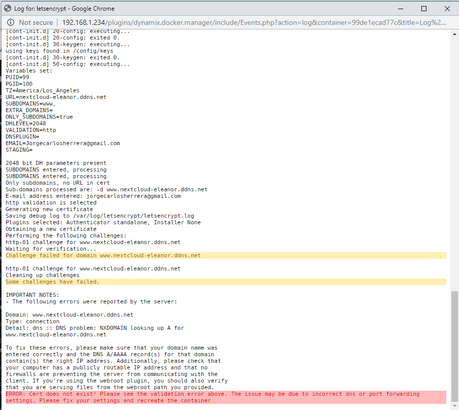

@saarg @CHBMB ErrorWarningSystemArrayLogin [s6-init] making user provided files available at /var/run/s6/etc...exited 0. [s6-init] ensuring user provided files have correct perms...exited 0. [fix-attrs.d] applying ownership & permissions fixes... [fix-attrs.d] done. [cont-init.d] executing container initialization scripts... [cont-init.d] 10-adduser: executing... ------------------------------------- _ () | | ___ _ __ | | / __| | | / \ | | \__ \ | | | () | |_| |___/ |_| \__/ Brought to you by linuxserver.io We gratefully accept donations at: https://www.linuxserver.io/donate/ ------------------------------------- GID/UID ------------------------------------- User uid: 99 User gid: 100 ------------------------------------- [cont-init.d] 10-adduser: exited 0. [cont-init.d] 20-config: executing... [cont-init.d] 20-config: exited 0. [cont-init.d] 30-keygen: executing... using keys found in /config/keys [cont-init.d] 30-keygen: exited 0. [cont-init.d] 50-config: executing... Variables set: PUID=99 PGID=100 TZ=America/Los_Angeles URL=nextcloud-eleanor.ddns.net SUBDOMAINS=www, EXTRA_DOMAINS= ONLY_SUBDOMAINS=false DHLEVEL=2048 VALIDATION=http DNSPLUGIN= [email protected] STAGING= 2048 bit DH parameters present SUBDOMAINS entered, processing SUBDOMAINS entered, processing Sub-domains processed are: -d www.nextcloud-eleanor.ddns.net E-mail address entered: [email protected] http validation is selected Generating new certificate Saving debug log to /var/log/letsencrypt/letsencrypt.log Plugins selected: Authenticator standalone, Installer None Obtaining a new certificate Performing the following challenges: http-01 challenge for www.nextcloud-eleanor.ddns.net Waiting for verification... Challenge failed for domain www.nextcloud-eleanor.ddns.net http-01 challenge for www.nextcloud-eleanor.ddns.net Cleaning up challenges Some challenges have failed. IMPORTANT NOTES: - The following errors were reported by the server: Domain: www.nextcloud-eleanor.ddns.net Type: connection Detail: dns :: DNS problem: NXDOMAIN looking up A for www.nextcloud-eleanor.ddns.net To fix these errors, please make sure that your domain name was entered correctly and the DNS A/AAAA record(s) for that domain contain(s) the right IP address. Additionally, please check that your computer has a publicly routable IP address and that no firewalls are preventing the server from communicating with the client. If you're using the webroot plugin, you should also verify that you are serving files from the webroot path you provided. ERROR: Cert does not exist! Please see the validation error above. The issue may be due to incorrect dns or port forwarding settings. Please fix your settings and recreate the container
[Support] Linuxserver.io - SWAG - Secure Web Application Gateway (Nginx/PHP/Certbot/Fail2ban)
I have change the variable to false. I still keep getting this. ERROR: Cert does not exist! Please see the validation error above. The issue may be due to incorrect dns or port forwarding settings. Please fix your settings and recreate the container

When i look at the address in the No-IP website, it is the correct to my wan ip. My isp does not block port 80. @saarg
