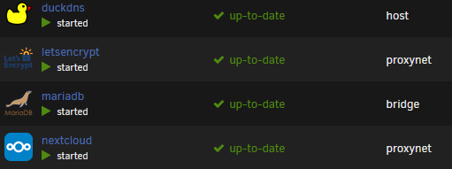

  18. I'am using Letsencrypt explicitly for Nextcloud
