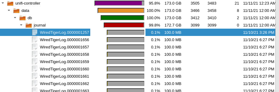

  1. I have been using that for years and updated it the other day - then it all went south Anyway - I have deleted the WiredTigerLog files and I can start my VMs again. Thanks GOD I appreciate your fast and useful help!
  2. I have these I've just found out that unifi.controller produces a lot of 100MB "WiredTigerLog" files every minute 😲

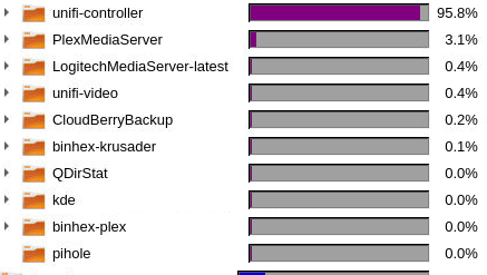

  3. I just tried to delete some of the appdata - that was enough so I'm running QDirStat to see what's piling up. Thanks a lot so far! 🙏

  8. Hi. Apparently I have something installed or setup so my cache drive is filled to the limit; 0 bytes left 😞 Now I'm not able to start the Docker service and my VMs seems gone 😢 I have tried to move all shares away from the cache drive, but it doesn't help. I would've liked to run QDirStats (to help me solve what is going on and clean up), but as my Docker service is down, that's not possible. Where do I go from here? Please tell me what info you need to give a hint. Thanks

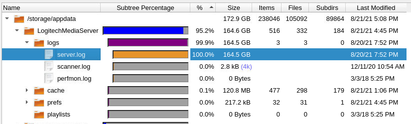

  9. One last question: I found out that the unwritable directory (/config/cache/tmp/) had "root" assigned as both user and group. So I tried to uninstall the container, wiped the directory in appdata and installed the docker again. But it's still the same. Isn't that wrong? And is it in the container or the LMS the error exists? Thanks

  12. I may have found a problem; I have these [21-08-20 14:43:22.1482] main:: ([undef]) Warning: [14:43:22.1481] EV: error in callback (ignoring): Cannot write to '/config/logs/server.log': at /usr/share/squeezeboxserver/CPAN/Log/Log4perl/Appender/File.pm line 241. [21-08-20 14:43:22.1482] main:: ([undef]) Warning: (in cleanup) Cannot write to '/config/logs/server.log': at /usr/share/squeezeboxserver/CPAN/Log/Log4perl/Appender/File.pm line 241. [21-08-20 14:43:22.1488] main:: ([undef]) Error: Select task failed calling Slim::Networking::Async::HTTP::_http_read_body: Error in tempfile() using /config/cache/tmp/XXXXXXXXXX: Parent directory (/config/cache/tmp/) is not writable for every 8th millisecond 😬

  14. Hey there Thanks for this great docker 👍 I've just noticed that my server.log is 165 GB (!). Isn't there som rotation on this file?
