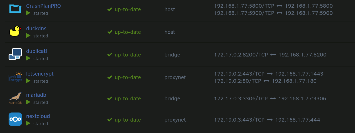

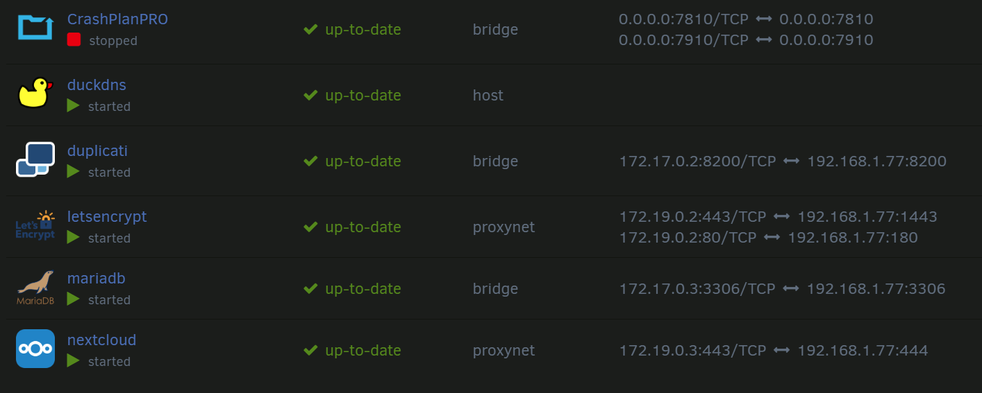

  7. Thanks for the reply, even with everything default it still doesn't work.
  8. Hi everyone, I'm having trouble getting my Crashplan Pro docker to connect. When I login it just says 'unable to sign-in'. Crashplan Pro works fine on my main PC and the same network. I think it may be an internal port conflict. I have a few other docker services running (see attached). Anyone know if this can be a problem or how to fix it?
