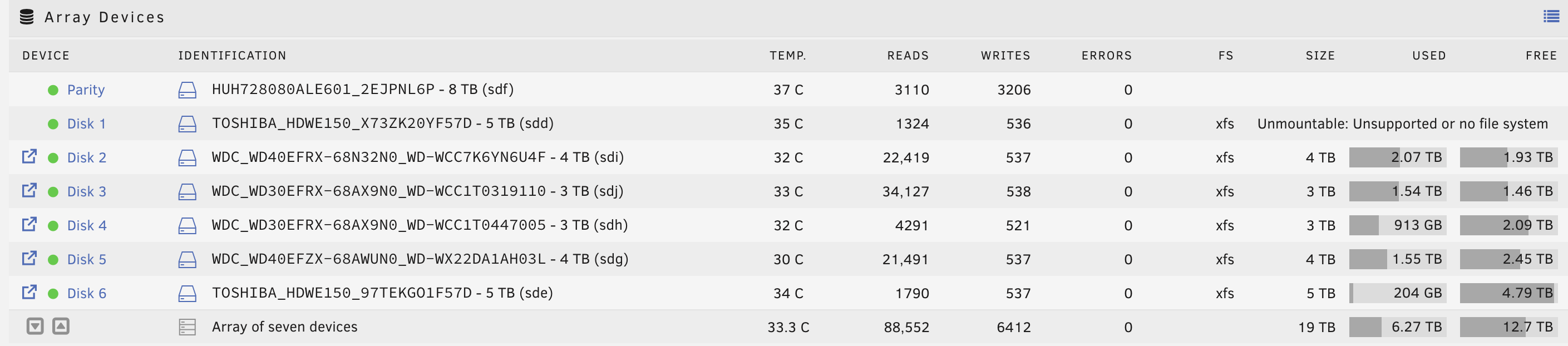

  3. Yay! Mounted successfully. The lost+found folder would be in the root of the drive right? In my case: /mnt/disk1? If so, I don't see any lost+found folder in there.
  4. Not sure if this is good or bad.... Is it just try to start the array normally now? Phase 1 - find and verify superblock... Phase 2 - using internal log - zero log... ALERT: The filesystem has valuable metadata changes in a log which is being destroyed because the -L option was used. - scan filesystem freespace and inode maps... clearing needsrepair flag and regenerating metadata sb_fdblocks 488961967, counted 490185727 - found root inode chunk Phase 3 - for each AG... - scan and clear agi unlinked lists... - process known inodes and perform inode discovery... - agno = 0 - agno = 1 - agno = 2 inode 5221924220 - bad extent starting block number 4503567550832887, offset 0 correcting nextents for inode 5221924220 bad data fork in inode 5221924220 cleared inode 5221924220 - agno = 3 - agno = 4 - process newly discovered inodes... Phase 4 - check for duplicate blocks... - setting up duplicate extent list... - check for inodes claiming duplicate blocks... - agno = 0 - agno = 3 - agno = 1 - agno = 4 - agno = 2 entry "IMG_2660.JPG" at block 1 offset 3136 in directory inode 5221034101 references free inode 5221924220 clearing inode number in entry at offset 3136... Phase 5 - rebuild AG headers and trees... - reset superblock... Phase 6 - check inode connectivity... - resetting contents of realtime bitmap and summary inodes - traversing filesystem ... bad hash table for directory inode 5221034101 (no data entry): rebuilding rebuilding directory inode 5221034101 - traversal finished ... - moving disconnected inodes to lost+found ... Phase 7 - verify and correct link counts... Maximum metadata LSN (39:3996936) is ahead of log (1:2). Format log to cycle 42. done
  5. Thanks @JorgeB. I'm getting this. Maybe because I ran the above already? Should I go ahead and run it with "-L"? Phase 1 - find and verify superblock... Phase 2 - using internal log - zero log... ERROR: The filesystem has valuable metadata changes in a log which needs to be replayed. Mount the filesystem to replay the log, and unmount it before re-running xfs_repair. If you are unable to mount the filesystem, then use the -L option to destroy the log and attempt a repair. Note that destroying the log may cause corruption -- please attempt a mount of the filesystem before doing this.
  6. I recently found one of my drives as "Unmountable: Unsupported or no file system". From directions in the forums, I ran: "xfs_repair -v /dev/sdd" from the console It gave me the error: "Sorry, could not find valid secondary superblock Exiting now." The drive still is unmountable. Any other ideas on bringing this drive back? I see instructions on looking for a lost+found folder but I don't see that anywhere. The drive never appears in Unassigned Devices with the array stopped or in maintenance mode. With the array started, I don't see the folder in /mnt/user
